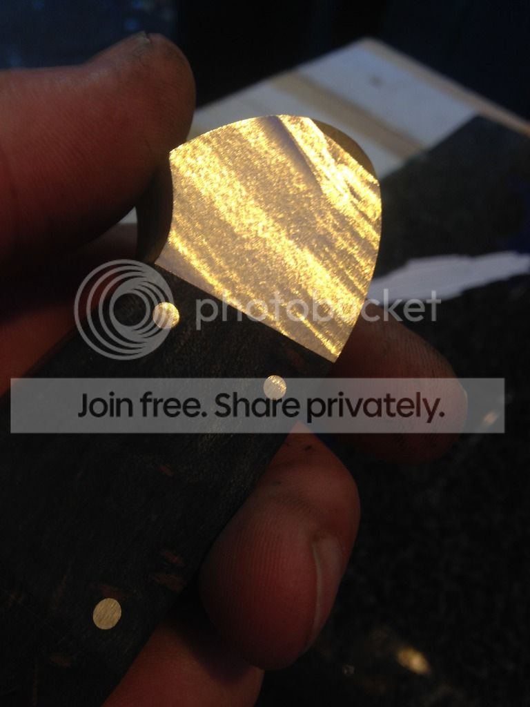

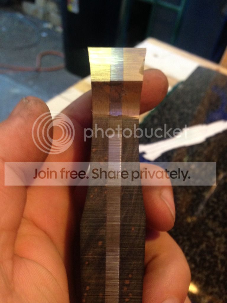

I found myself at a crossroads this weekend while shaping a handle. I currently only have a flat platen and a small wheel attachment for my 2 x 72 and don't have the funds for a large wheel attachment, which at this time would make the task of shaping the handle of the knife I'm currently making easy/possible with my current skill set. As seen in the image below, the handle has a palm swell with a good sized curve on the back. An 8" or 10" wheel attachment would make easy work of this.
I attempted to make it work with my platen and one of the 2" wheels and it didn't work out so well and I got a lot of ripples in the shape which proved to be hard or next to impossible "for me" to fix considering the knife has a set of bolsters in the design at the back of the handle and the wood removes at a much quicker rate than the brass when trying to sand/file it.

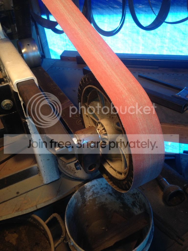

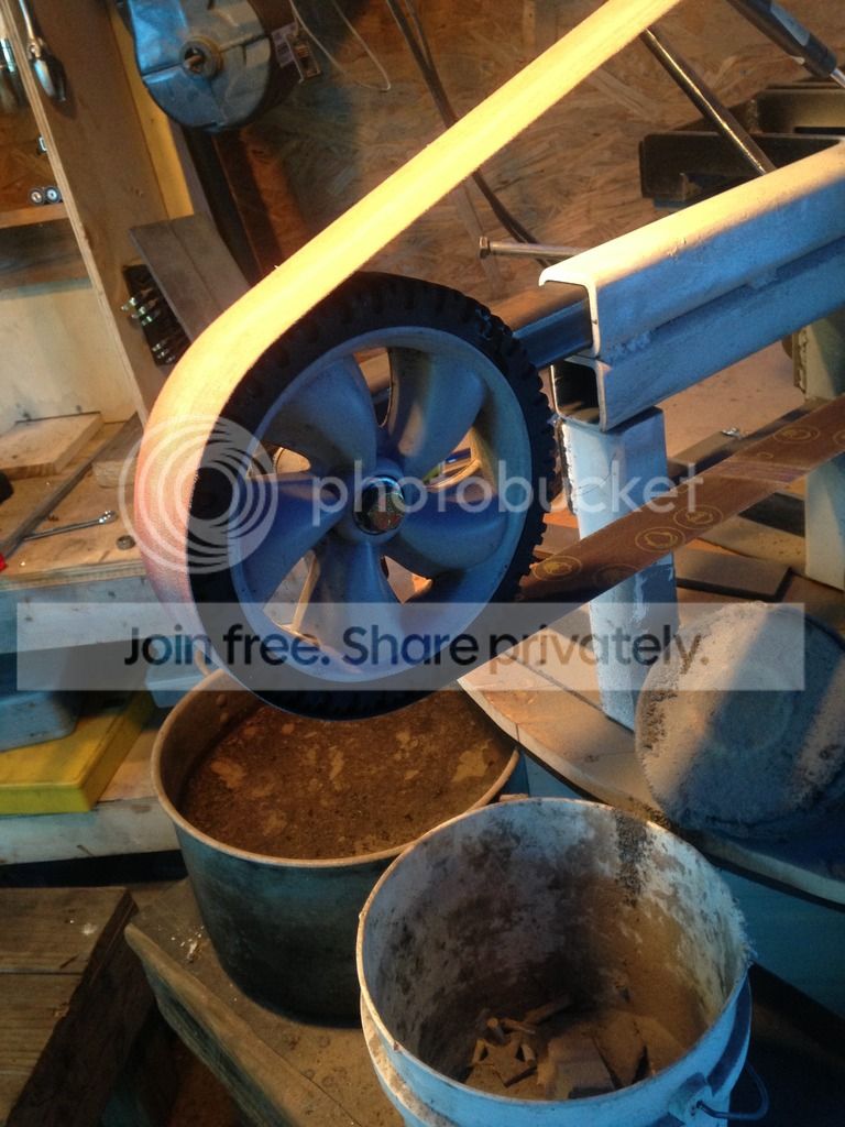

Then suddenly the thought hit me as I was sipping my morning cup of coffee to go out back and look at some old half running push mowers my moms new husband had just given me (he basically didn't want to load them up and bring them to the dump and gave them to me). And there is was, the solution to my problem. There sat on the back of one of the completely non running lawnmowers, an approximate 2" wide 8" diameter wheel with a bronze or some kind of metal bushing that fit almost perfect on the shaft of a 1/2" bolt. I spent the next 45 mins digging out washers and spacers trying to get it lined up and setting the tension so it didn't wobble and didn't drag too much as it's just a wheel off of a lawn mower. Luckily I only need to use it just slightly faster than the slowest speed of my grinder.
So here is what I came up with.

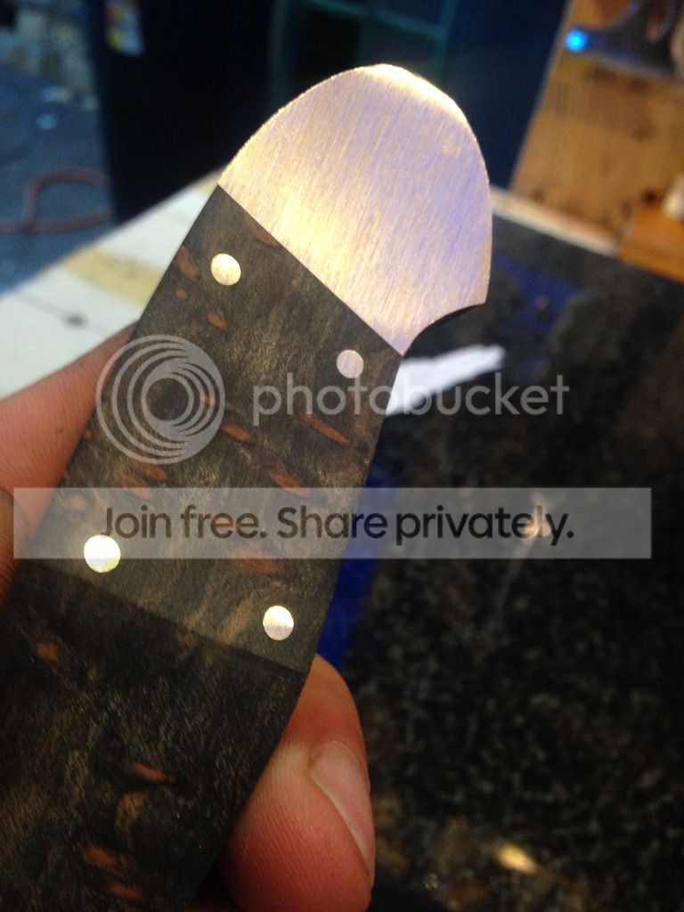

I still need to do some more shaping, but that is down hill work now that I have the smooth shape I desire. I think it worked pretty well.
****Note: I would NOT attempt this if you do not have a variable speed grinder and can use it at a VERY SLOW speed. It's a lawnmower wheel. USE COMMON SENSE and PPE****
