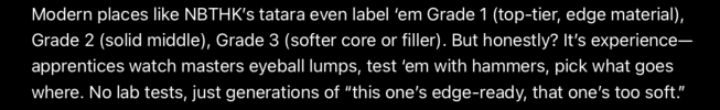

Pretty neat..... Those are all the cast.off bits with too much impurities????
It is a.Pretty thing when they crack the bloom open and show.the inside...👍
Yeah, I saw similar pieces that were bright silver with the colors in them and they were A1 grade on Ebay. I just don't know what my stuff would be considered grade wise. I've seen other pictures of pieces that were darker black color that were supposedly lower quality tamahagane. I am guessing the stuff I have is good quality, but no idea how to tell. I did ask about the colors on a Japanese sword forum before and if they were from impurities or particular elements being present and was told that they weren't, it was more from how the metals cooled or something?
