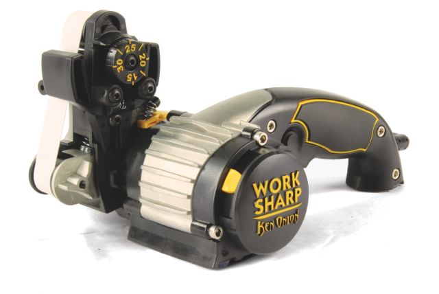

Are you referring to the blade grinder or the regular work sharp? If the regular how are you adjusting tension?
The KO, regular sharpener. There's a little yellow lever on the side of the motor on the opposite side from the belts. Isn't that a tension thing? If not, I may be even more of a goober than i thought.
To be clear, Im talking about the yellow tab you clearly see front and center right here (to the left of the "W"):
Booby, as per picture above posted by 19-3ben.

Ahhh, you're referring to the tracking knob...It doesn't adjust tension, it centers your belt on the pullies....The lack of a tension adjuster is the reason there's no leather strop for the regular ko, there's no way to counter the leather stretch.
Yup. I'm more of a goober than I thought. I'll have to advise the wife and see where she wants to go from here.

Lol no worries, I thought maybe you made a secret discovery lol...kinda like to eliminate the guides from moving during sharpening you tighten the Allen screws behind the guides...Then you can apply pressure to the guides to keep a consistent angle while you draw the knife thru.
When i was new to the WS, I actually was getting beautifully polished but dull blades. Then realized I hadn't tensioned the belt, and it was probably wrapping itself around the edge, and dulling as it was riding along. Whoops!!!! As soon as I upped the belt tension that all went away and now I get scary sharp edges.
As has already been mentioned, the tension is indeed fixed. What you were experiencing could be attributed to putting too much pressure on the blade in your early sessions. This could have contributed to some wraparound.
