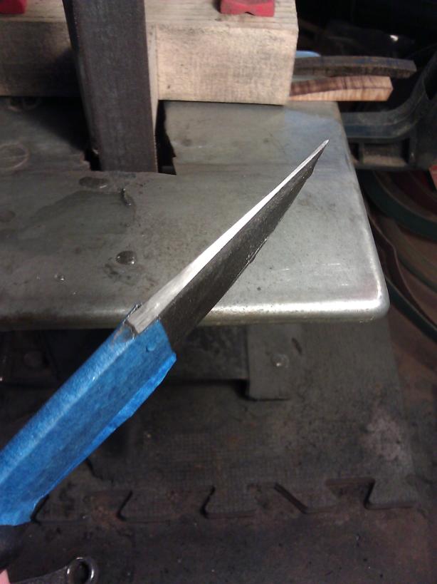

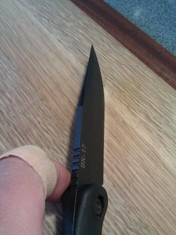

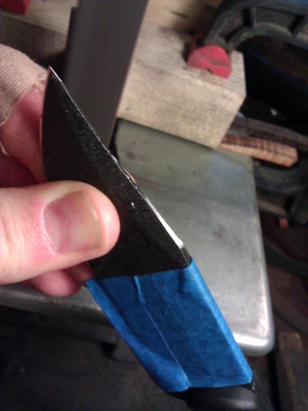

Did it.
Do I like the new profile? It is made entirely of awesome.
on the little 1x42, cold-blued the surface. I broke the sharp edges with some 280g.
shiny at the tip and back of the clip - these will converge in the middle
like so:
and a natural background
-Daizee
Nice work. When I saw the first photo, I didn't care for it too much, but after seeing the second photo, with the wood background I did.

Looks great. Seems to have a more definite pointy end. How "stabby" is it?
it is MORE stabby but a bit stronger. The point is about 0.050" lower, and right where the primary grind and swedge meet. It was a bit high before. One of my usual gripes about concave clips is that the point is too high above the center line. I haven't stuck it in any stumps yet.

I was considering hand-sanding off the coating on the bevels and leaving the flats black... but I have too many knives of my own to sand, so that probably won't happen.
