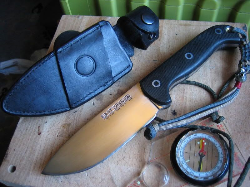

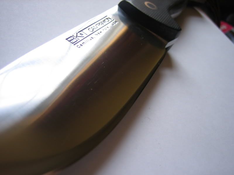

Next step was to decide on a knife. I wound up going with the BK-2 for a few reasons. First, it's a smaller Becker, so there's less sanding involved. Next, I like the traditional blade shape of the BK-2 a little more than that of the tanto-shaped BK-10. And finally, the BK-2 has a little more history in that Ethan put out a Campanion at Blackjack before the Becker line moved to Camillus.
Tom at Chestnut Ridge Knife Shop still has some BK-2's left, so I got my order in and took receipt of the knife today. Great blade with which to start a project. Good grind, nice machining all around, and virtually no pitting on this one. I couldn't have been happier with it.
Here's what I started with:
Here's what I hit it with:
And here's what I wound up with:
To be continued...

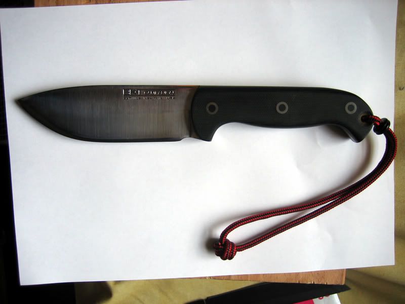

Hello Guyon.
You have made a good choice with the BK2 because it gives you far more steel in the handle area than is required.
This means that you can reshape the tang to suit your own hand.
I have tweaked my BK2 a bit more since that last photo was taken....
Here is a photo beside yours to show just how much steel I removed from the tang...
It took me a long time to finish this knife... not because of the work involved...but, because I had to think about what I had to change to get it to feel right in the hand.

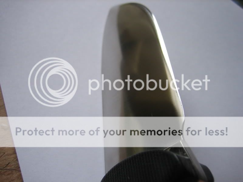

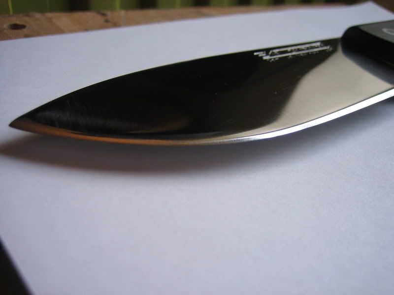

I also thinned out the edge to convex grind using nothing more than different grades sandpaper on top of a strip of foam.
I wanted this knife razor sharp... and this was the way to achieve it.
The highly polished edge is a real slicer now. :)

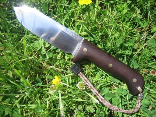

My latest modification was this BK9.
Feel free to PM with any questions, Guyon.
