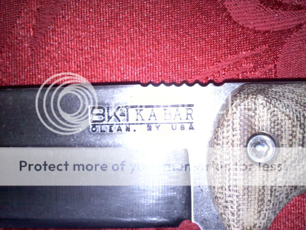

I know there is debate about the usefulness of jimping on a blade, but I like the way it looks and feels. Here's what I did on my BK-2. I did this using a dremel with the extension and a diamond file bit from Harbor Freight. It was just the right size. The key is to take your time. Sorry for the blurry pic - it was from my phone.

Good looking jimping there will. Was it hard to keep it lined up or did the dremel make easy going of it?
There are two keys to it: 1) You have to mark it out really clearly and have in mind how deep and how far apart you want the cuts, and 2) You gotta stay really steady and keep it at a moderate speed, because it will try to dance around.
The extension shaft made it a lot easier. This is the fifth knife I've tried this on, and that thing made a huge difference in controllability.
Other things to consider are whether or not you want flat spaces on top between the cuts, whether you want the scooped kind like this or shallow, smaller cuts like a Spyderco. They both work, it's more of an aesthetic or feel thing for each person. Also, when it looks good, leave well enough alone. I've screwed up a few by trying to "touch up" something that was already fine.
