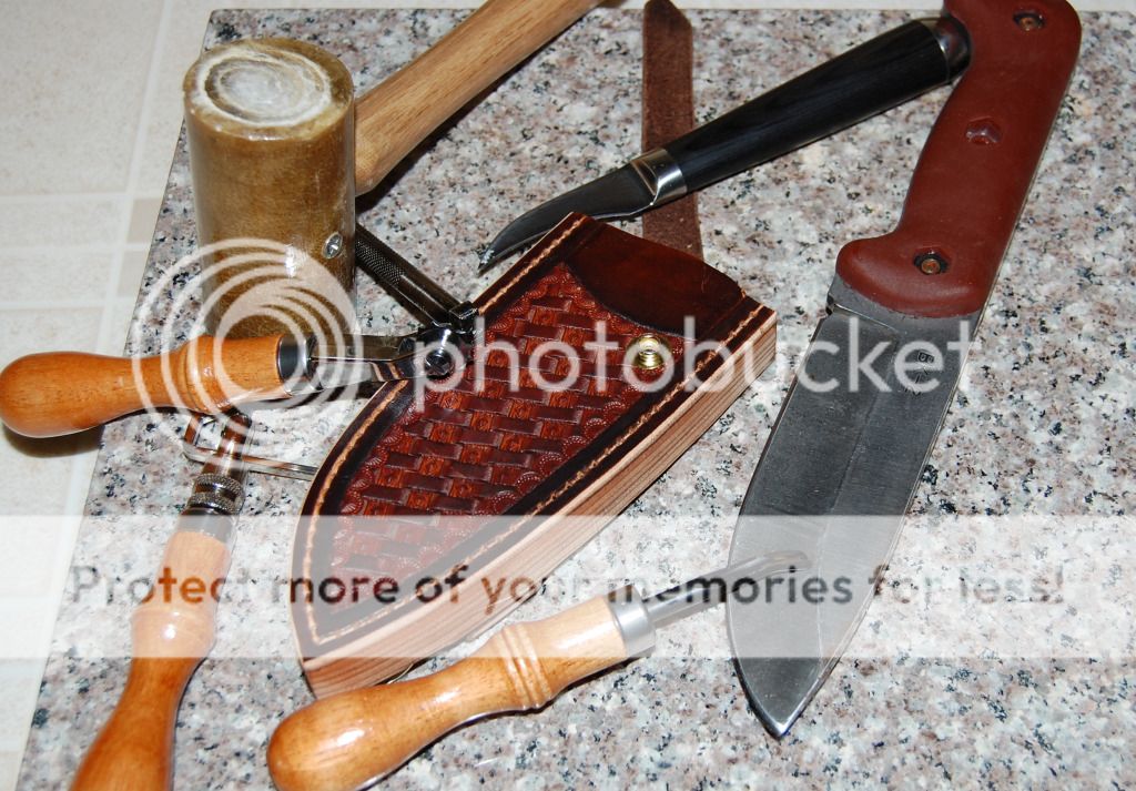

I just saw the update photos. Looking great! How do you get that textured pattern into the leather? I'm a total newb with leather sheathmaking.... is it some sort of stamp system?

I'm a newb too. Just started this past Christmas. I'm in the Air Force and live away from my family and needed something to occupy my free time. Yes, all that you see is by a single basket weave stamp repeated over and over again. And then the simi circle border is another stamp done after the basket weave. If you notice in the first photo, I did not take the basket weave all the way to the edge. So, the border stamp just kind of ties everything together. I am loving leather craft. It's something that I have wanted to do for years and now I am finally starting to do it. Thanks for the kind words and following my thread.

Work has been busy......hate when it interferes with my play time. So, here is an update. The sheath is assembled, stitch grooves, and holes placed. This is what it looks like now. I will finish the edges when the stitching is done.
After it is stitched, I will wet mold it and then it will look something like this:

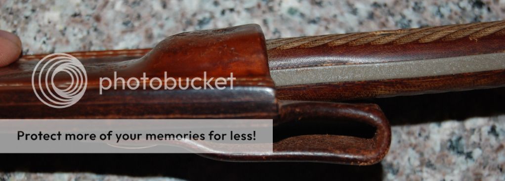

I designed the sheath to be capable of right hand vertical carry. So....When I sew the belt loop on the back (think right hand vertical) it will be blade up for scout carry. It would also be blade down for right hand cross draw. Clear as mud? I'm gonna go ahead and sew the belt loop to the back and post pic. Then it will make more sense.

This project started with the first picture in this thread and this is where we wind up. The only thing left to do is smear a last coat of Montana Pitch on it to weather proof it and buff it out. Oh yea, and take it to the UPS store to get it on it's way to thrillbilly. BTW the background is the leather side that this sheath is made from.
