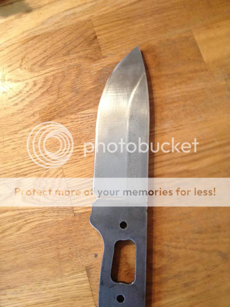

Are you talking about the transition between bevels? Almost like having a full flat grind or convex? This is what i did to mine. (though it happened from me removing the coating with a belt sander not chemical stripper)
Thanks guys. That's is exactly the look I'm after. Sorry I'm not up on the terminology. I guess I really like a full flat grind. Although, I want to save the logos. Is a belt sander the way to do it? I would think it could hurt the temper.

No problem, and welcome! Beckers are great fun to mod! If you go slow and keep dipping it in cool water you are fine. Just keep feeling the blade and don't let it get above warm. If you are patient you will be safe.
Yeah, belt sanders are the key...I don't think you're gonna be able to save the logos though. My pics above are kinda old since after I took them I went and reground the blade again so only the "BAR" part of Ka-Bar is still there.

You could just knock the shoulder off the grind (the hard line where the grind starts) and it would give the blade a smooth transition like Nsvens89's BK2. You can sand it down enough to where it would flow smoothly and there would be no noticeable transition but you would preserve the logo.

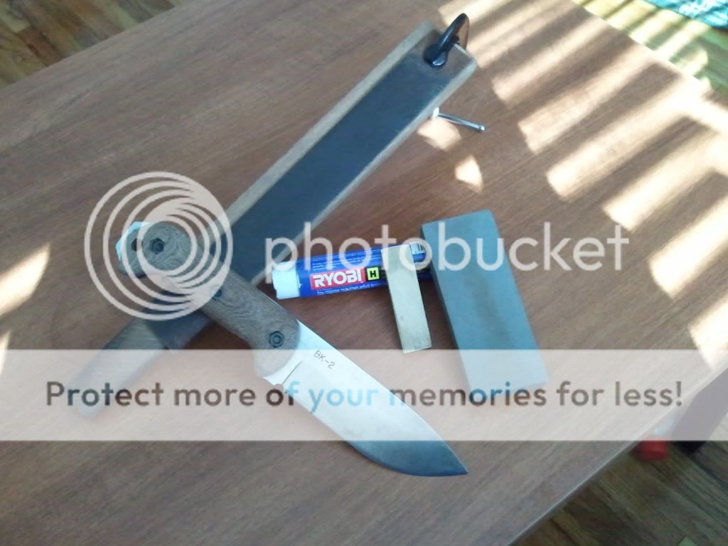

Well i sanded the line off, but i guess i didn't etch the logo deep enough. Im thinking ill take it the rest of the way off. Gonna sleep on it and see. I used a fine file, then some 80 grit sand paper. The paper is where i got a little carried away. After that, i took it all the way to 400 grit. The knife never got more then warm to the touch. i also filed the spine, and got rid of the grind marks. I think i am going to round the spine too. Im thinking if i force a patina, i shouldn't have to take it any further then 400? Anybody know for sure? Does it make sense to go up to 1000 or more?
I took mine all the way down to 2500, it was shiny and purdy. Then I patina-ed the crap out of it with hot apple cider vinegar. If you are goin to force a patina, then I would just go down to 1000. That way you get all the scuffs out, and your patina is nice and even. Just my opinion.

I'd agree with that - take it to 800 or 1000 to get it nice and smooth, but don't take it all the way to polished if you're going to force a patina.

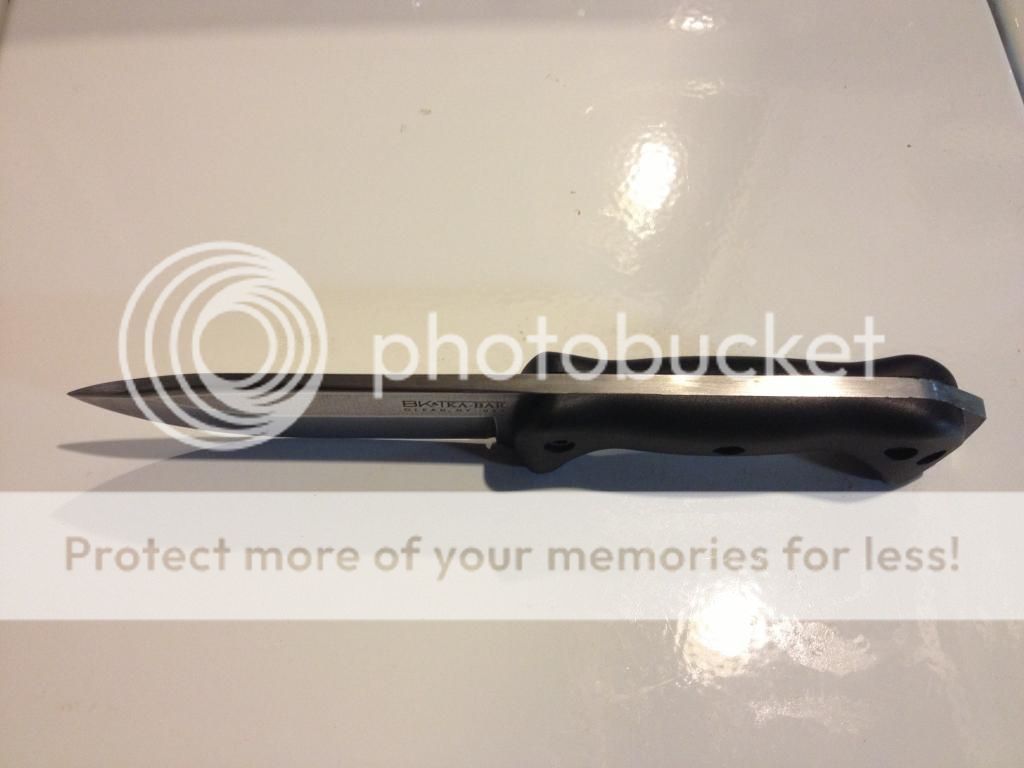

Hew want chiny? I gib you chiny:
Please note: these photos are for reference only. I DO NOT POLISH KNIVES FOR CUSTOMERS! Too much time and elbow grease involved to make it worthwhile.
Hey k9, great pics. How long did it take to pull that off? What grit did you go up to before polishing? I assume at that point they pretty much just sit in a drawer.
Literally hours and hours. It was one of those "let's see if I can do it" moments. Luckily I don't have those too often! :D
Up thru 1000 before switching to a buffing wheel and compound. As most of you know, that factory coating is more than just something to protect the steel from the weather. It also serves to hide a myriad of sins from manufacturing. Like looking in a mirror while you're nekid, sometimes "bare" needs a lot of work to be presentable! :D

I really should have started with a 400 grit to get the tooling marks out. But I started with 1000, this pic is horrible, and it was a lot more shiny than it looks, oh well.
