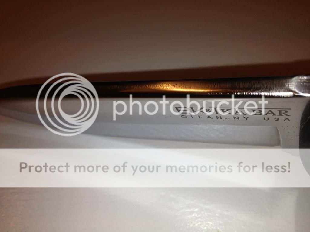

There's actually good reason to sand to a mirror finish (which you should do tip to ricasso). You're putting microscratches into the steel, and as you can imagine, those can retain more moisture the bigger they are, and will thus make it easier for rust to take hold, and also there's more for the material you're cutting to grab onto and cause friction. I'd sand to at least 600 grit, and probably take it clear to 1000 or even 2500. Here's my BK2 FFG in one of the earlier stages of sanding. You can see there's still some tooling marks:

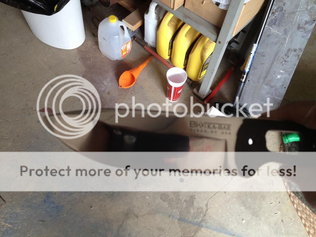

spent about an hour on it today after work. Started again at 220 and got it up to 1000 grit. (220,400,600,800,1000) All wet sanding by hand (NO POWER TOOLS). Once i got done sanding, i hit it by hand with red rubbing compound. You can easily fix your hair, or pick your teeth from this blade now. Im not sure if im going higher or not. This was so easy, i have no worries about beating on this thing and touching it later if need be. Now for some pics.
There is no sign of the grind line on the BK2 side, but theres no longer any BK2 markings either. The grind mark on the side with the BK&T Kabar logo isn't nearly as visible in person as it is in these photos. I may go at it again and try to smooth it out some more, but im going to use it like this for a while. This was seriously a piece of cake getting it to this point.
