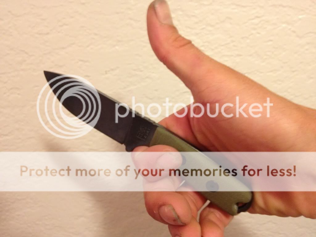

Hey beckerheads, I received my bk 24 in the mail and love it. I plan on modifying it in small ways to make it a bit nicer and make it look clean. here is what i had in mind: clean up the edge, polish the blade, buy it a nice leather pocket sheath, stipple the factory black grips or dye the orange ones crimson and stipple, and jimp the entire handle section. in my opinion the bk14/24 is a bit slippery, hence all the traction mods. The jimping will be a feat indeed as I will be doing it with just a diamond file. I will post my results as I complete them. my question to you guys and gals is who would you recommend to make a leather sheath for it? Also, who makes a very small triangular diamond file? i cant seem to find one that looks to be of good quality. Here are the pics.

I tried cutting a grove with a hack saw blade and a file. It didn't even scratch it. I squared off the spine and did a little work on the rest of the handle squaring it off too. My only option to get some jimping on this thing is probably to use a diamond file... or two. I definitely like those tkc scales. I would definitely make some g10 scales on my own but living in barracks limits my dremel usage. The skystorm pocket sheath looks close to what I want but isn't perfect. I might have to draw up a custom order from one of these guys. thanks for the help guys. I'll keep you posted.

If you can use a round diamond file...... V notches tend to build stress risers and crack propagation can follow.....probably not a problem but, Avoiding problems is always good.....A shame the Dremel option is off the table, they save a lot of elbow grease, they do, they do.....Looking pretty .......

Thanks for the advice on that crack propagation issue mr. becker. I posted in another forum asking if a spyderco sharpmaker stone would work to make the small groves. here is the thread if anyone is interested. http://www.bladeforums.com/forums/s...-can-someone-with-a-sharp-maker-do-me-a-favor Based on the responses i bought some triangular stones from congress tools, they are not as sharp as a needle file and will likely result in a round bottom groove. I will do some tests to confirm this before I grind on this 24. I definitely don't want to end up cracking this baby. I do have high hopes though.

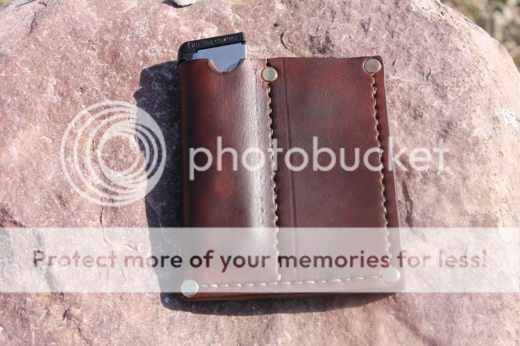

psyop, I like that mag holster. stand by for PM.
I polished the blade a bit and finished squaring off the spine all the way around. Its starting to turn into a real looker.

Your 24 is lookin great - how were you able to square the spine and do such a nice polish job on such hard steel?

Wondering the same thing, it looks great! I gave up on polishing a 14 after a few days of sanding on it by hand...
Thanks for the compliments guys. I used about one full sized sheet of 400 grit sand paper wet and about 2 sheets of 600 grit and then proceeded to use bark river black compound and some green silicon carbide compound from a company I cannot remember the name of. The black compound is about 800 grit and the green I would say is like 4000. I actually made an awesome discovery that rubbing compound onto paper makes an excellent abrasive tool. It works just like sand paper (obviously) only its much cheaper and a little less durable. It is excellent for the flat surfaces of a knife.
