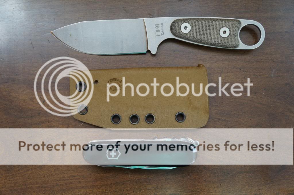

Made a kydex sheath for my BK-24. As you can see, I had some help making it...:D
Looks great!! I have made kydex sheaths in the past but could never figure out how to get the flared lip on the top. How do you/what do you do to get it like that? Is that another step after the sheath is initially formed? Thanks
After I form the sheath, I just take a hair dryer and heat up the kydex where I want to make the lip and, while wearing gloves, I just take my thumb and form it. If I don't like how it turned out, I just re-heat the area with the hair dryer and try again until I'm happy with the results. Hope this helps.

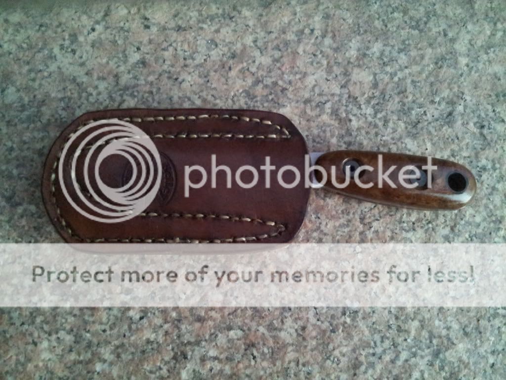

Psyop does some great leather work. I just got this one from him a couple of weeks ago and it's been in my front pocket everyday since then.
It has the same demensions as the factory sheath but a little thicker. Great retention and really comfortable!
The handles are mesquite burl and are about the same size/thickness as the zytel scales from Kabar. This is by far my favorite edc EVER!
