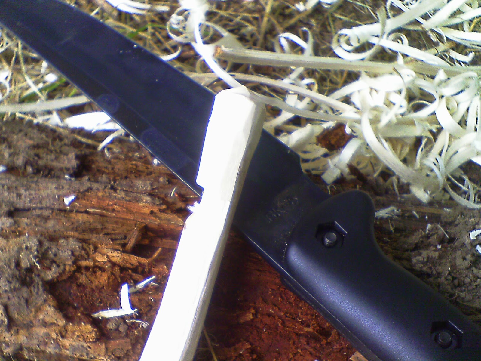

Got out for a short walkabout today, and got a nice shot of my etched 5.
I think the 5 is a wonderful knife
