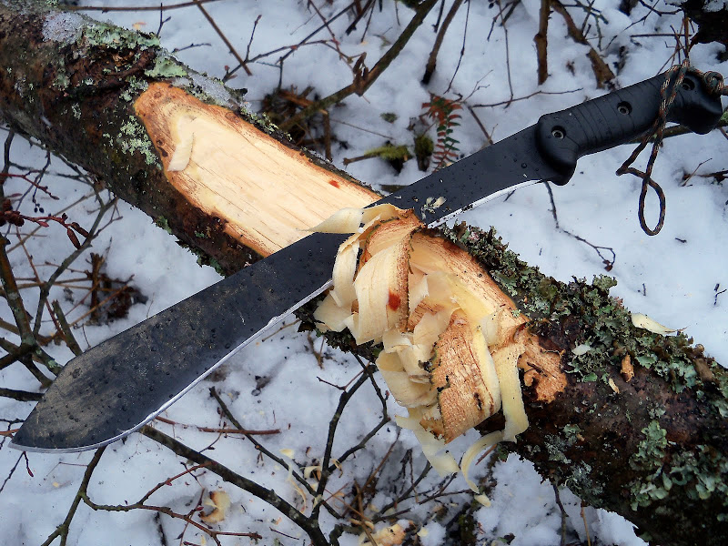

Finally I had a chance to get out and give a little workout to this Bk-6. The blade came to me fairly sharp, with some minor chippings. I touched it up with a sharpening steel previously.
First I chopped up some green twigs, one chop/one piece. Piece of cake...
For warm up I chopped a piece of (about 3" diameter) dead alder. Got through in no time.
Then I decided to use the Patrol Machete as a draw knife.
The little curve in the blade proved to be an advantage for this purpose and the length of the blade made it easy to grab and draw. The BK-6 produced nice, thin shavings with little effort.
More to come...
After that I did a little cross-grain batoning in order to make a notch in the log.
I used the machete as a draw-knife to clear the notch.
Here's an even larger diameter alder log chopped through and you can see how clean this blade chops.
Here you can see the two pieces of the log separated.
More to follow...
Some more "one chop-one piece" exercise. Notice the clean, one swing cuts...
For my next task, I put a quick point on a piece of wood with a few light chops.
Then, I decided to try the Patrol Machete at some more detailed work, like feather-stick making...
...and tent/tarp stake carving...
The stake cleaned up a bit more...
...and some more feather-stick from green wood this time.
More to come...
Using my "draw-knife" again, I made a small, flat "workbench" at the end of the previously chopped alder log.
Then some more feather-sticks...
This large blade is surprisingly good at this...
Here's the little travel companion of the BK-6... (Thanks Moose!)
Look at the depth of this one, light swing... That's quite the bite...
One more shot of the "battlefield"... Alders were slain, dismembered and the Patrol Machete had victory and total control...
I think this blade is pretty good, useful tool in the woods. If one gets to know the sweet spot, it does chop effortlessly and pretty much without felt vibration in the hand. It is light, but still a serious chopper and I think it does well for more detailed work.
So, there you have it.
I still have some time to have this BK-6 and might be able to do some more work and testing later.
Thanks for reading!
