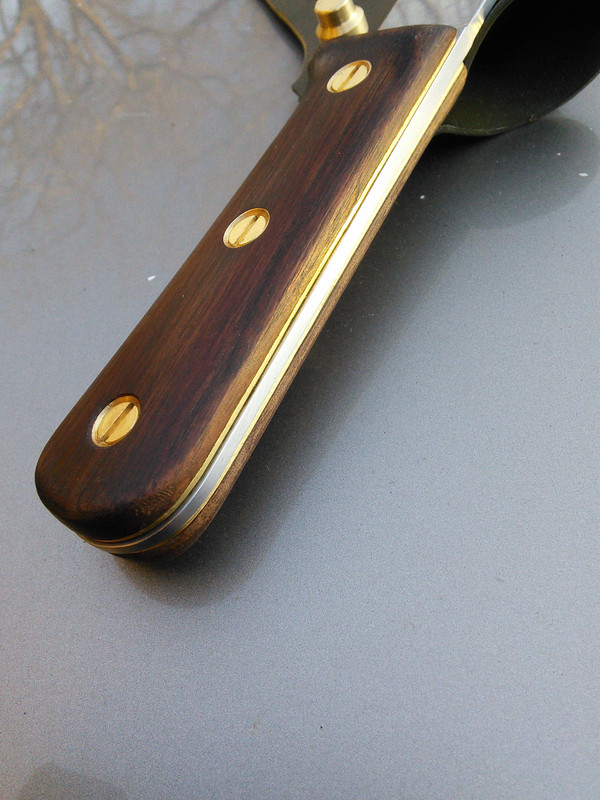

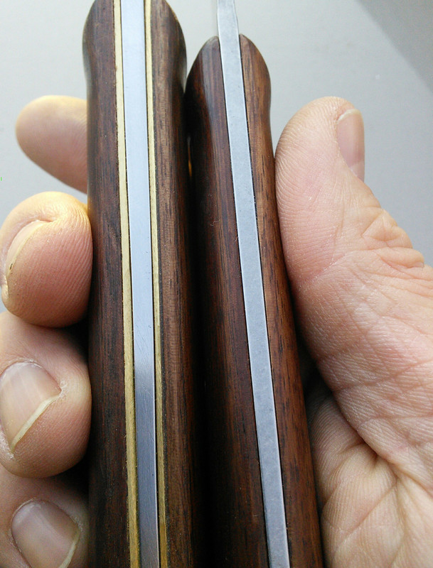

So I liked my plastic liners so much, I decided to step it up a notch....I replaced them with brass. They are .050" thick each. The handle feels great! Much fuller. I didn't weigh the knife yet but it probably doubled it? It's Very substantial feeling now. The ballanb point is right in the hand. It's not blade heavy for sure!
Initially I made them perfectly sized to the full sized tang. They looked beautiful.
But since the scales (at least Mine) are undersized, it felt lousy.... I could feel the edges on the brass, and it was uncomfortable. I decided to grind them down to the scale dimensions. I don't think they look nearly as nice now, but they feel wonderful....and it's a working knife. I epoxied the brass to the Walnut so there is no chance of shifting.
I really like it.
I really like it.

Nice work man. I'll bet that feels way different.

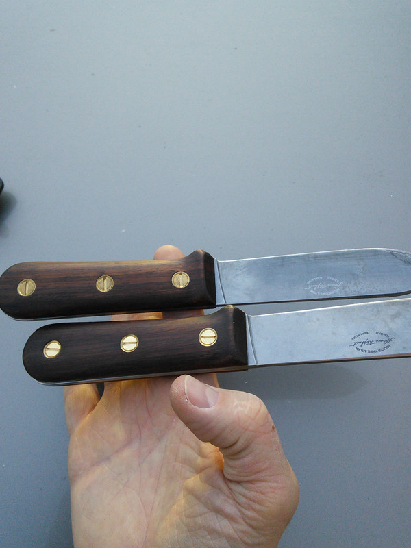

It's only weird because I have both versions.
The original is Perfect for my daughter, but this one just feels right now. Not totally sold on the extra weight though? In the hand, it's great, but still..... If I do another one, I might bore some holes in the scales to lighten them up? Idk.
If you mimic a skeletonized tang you can scoop a lot more weight out of brass liners. Drill the corners out of any shape which fits your need and join the drilled holes by cutting with something like a coping saw.
