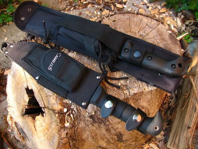

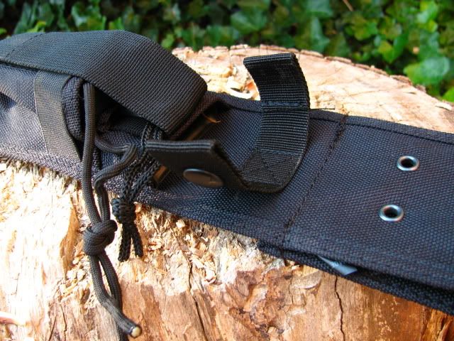

First, I liked the sheath. It's light weight and simple, and ruggedly assembled. I've heard some decry it but I think it's great for the price and for a real 'user' type knife. I don't have to worry about it getting dirty or scratched or anything. The pouch is pretty generous, and comfortably holds my Vic Rucksack, Army model firesteel, and some fatwood wrapped in jute twine. The single retention strap at the handle has a button snap, which I greatly prefer versus velcro. I jostled it upside down and no retention issues.

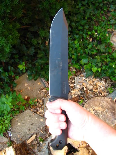

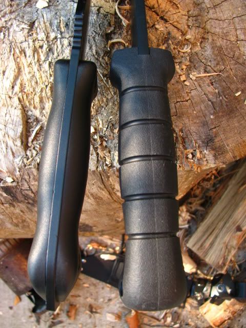

To the meat: I dig the BK9! It's got a bit of heft but handles like a much more lightweight knife. This aspect pleasantly surprised me. The handle dimensions seem to fit my hand a lot better than the BK2 did, and it actually feels more nimble overall than the BK2 oddly enough. I'm exceedingly grateful for intelligent contouring and circumference like this on a production knife. Good job.

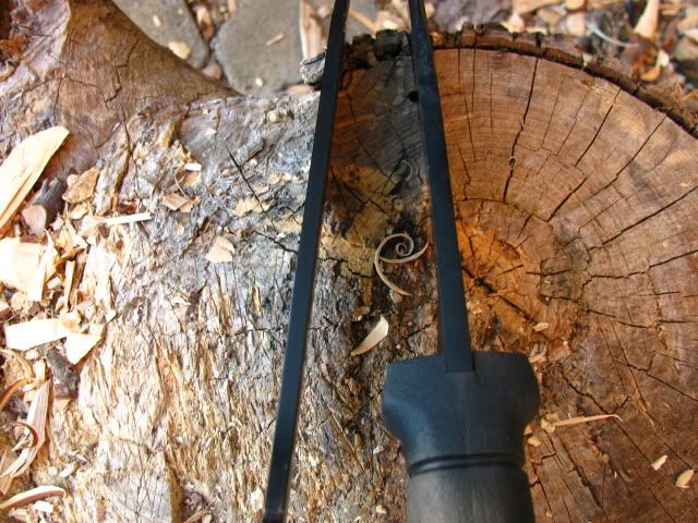

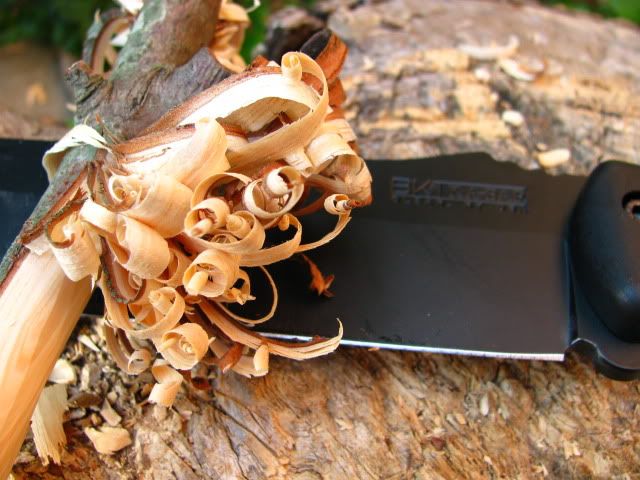

The edge came a bit toothy but sharp. Shaving sharp actually. I spent a little time with a stone and then a strop, and it's further improving. I had also been concerned that the edge would be to thick, considering the saber grind vs my full flat heavy bowie. But no worries, I found it plenty 'thin' at that area for tiny fuzz sticks. I also chopped and hacked at several types of wood with no detriment at all to my edge. [Depressingly, I did manage to let a piece of concrete come into the distal edge somehow and put some dings in it. They sharpened out easily though. Phew.]

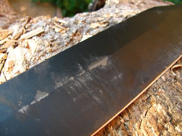

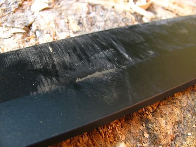

I took a large, thick piece of oak firewood and tried to baton through it after doing the basic chopping. The wood is veeery dense and tough to get through. There was a good bit of binding in the wood despite some intense wacks. Out of laziness, I 'reverse batoned' the knife back out of the wood. This was tough too. When I pulled it out, it had actually stripped off the coating in several areas at the beginning of the grind! The extent (depth) of the stripping was surprising vs other coated knives that have done this in the past. More alarming, the knife had also gotten very hot from the friction (almost uncomfortable to hold from the heat). I don't think it was hot enough to do harm. That's all, of course, my fault and not the blades.
Overall I'm quite pleased with it. It's got a great thickness for the blade length, and it handles well in both chopping and basic carving. Plus (vs a hatchet) I can do more cleaving of small branches or vegetation. It made fine notches, and fine fuzz sticks. Obviously plenty of target for batoning. Like I said, I'm a 'hatchet and 4"-er" kind of guy, but I think next time I go out I'm gonna try bringing just the BK9 to see how warm and fuzzy it makes me feel vs my usual combo.
The 'feel' is just a bit different with my Heavy Bowie. Both are fantastic knives as 'big blades'. Both chop very well. I love the flat grind of my HB, but I was not at all disappointed with the BK9 in that regard. The handle on the HB is wider/thicker, but I actually prefer the BK9. They actually both handle really, really similarly: the 1/4" thickness on the HB is offset by the flat grind and long swedge, and the BK9 is just a little less thick which takes some weight away. The BK9 I think chops a bit better. The sheath wins on the Becker, by a lot.
I'm happy that I picked it up vs the BK7 I think, Ethan gave some good advice! The 9 is a better balance/compromise I think. So if you're on the fence, just gopherit!

I am, however, thinking of stripping the coating after the binding incident. I'm not a hater of coatings in general, though.

awsome just awsome great review great pics.I especially like the fuzz stick pic showing the finer work a nimble BK9 can do.

I might duracoat mine...anyone think thats a bad idea? awsome pics spooky, authentic battle damage!
