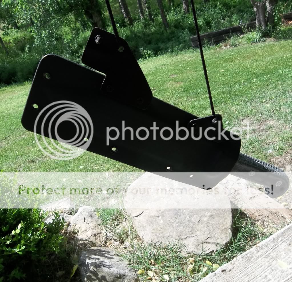

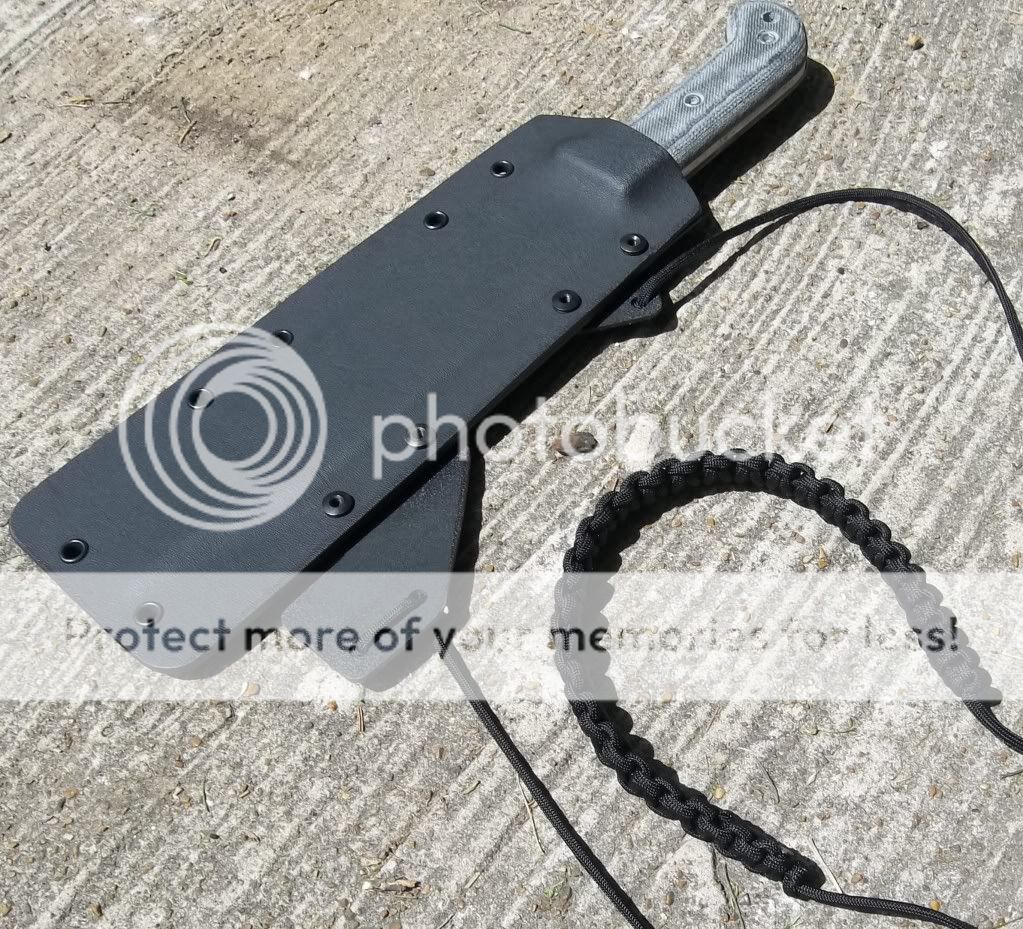

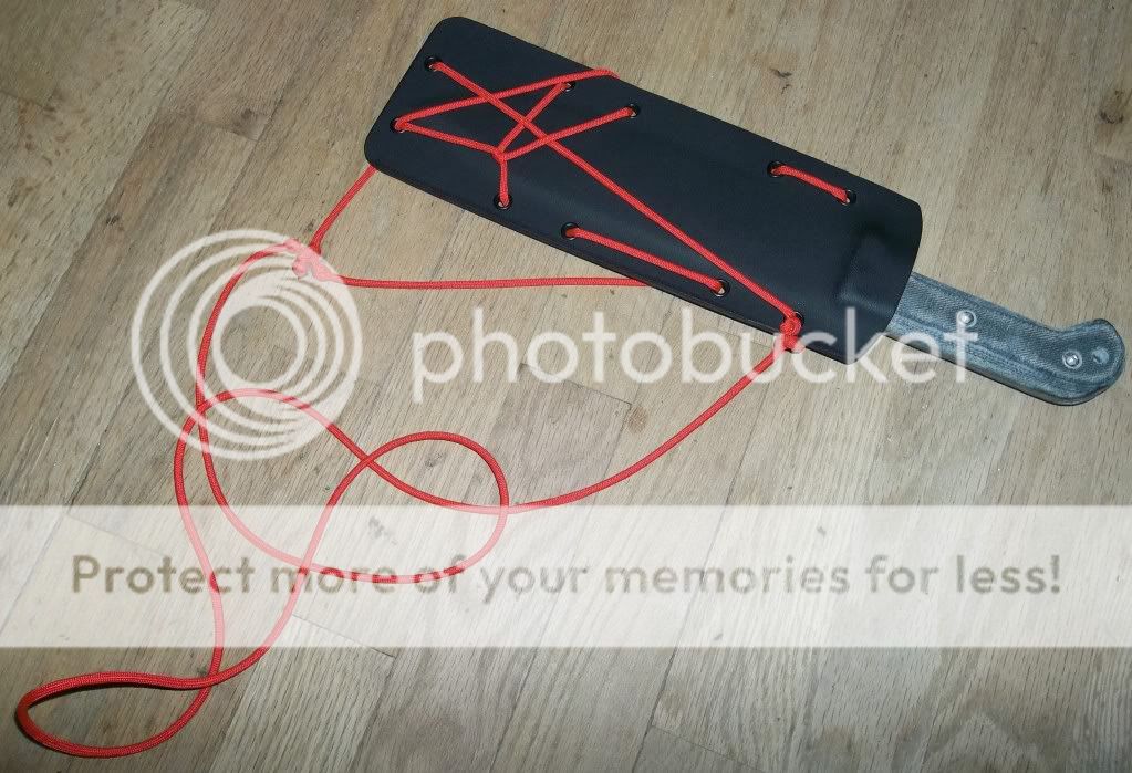

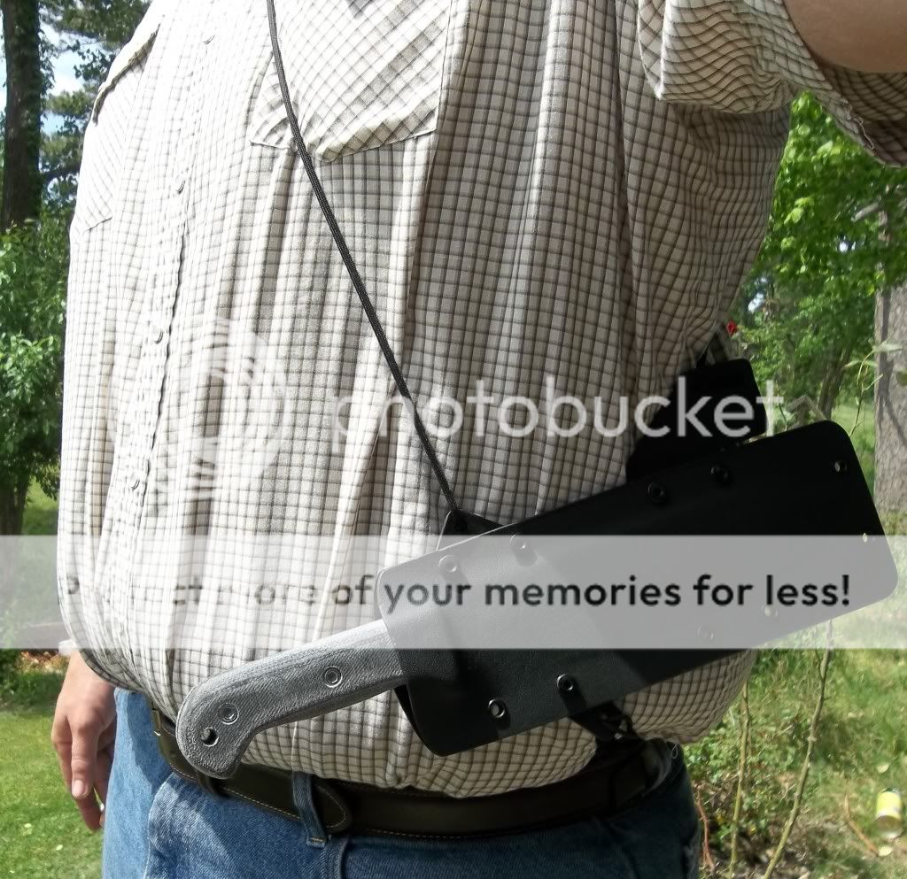

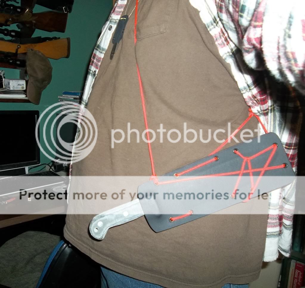

There was some interest in my thread last night about a shoulder rig for a BK9. I rigged a ''rough draft'' last night and worked it out in kydex/550 today. I like it, maybe the best carry method I've ever tried for a larger blade.
What I came up with last night...
And Phase 1 of the rig today...

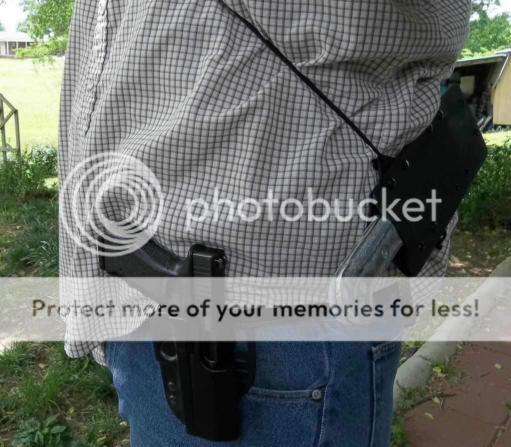

After wearing it for awhile..I realized it was a lil ''swingy'' and I couldn't draw it very well one-handed, I had to trap the sheath with my left arm to draw it, and it wasn't very smooth or fast...so back to the drawing board!

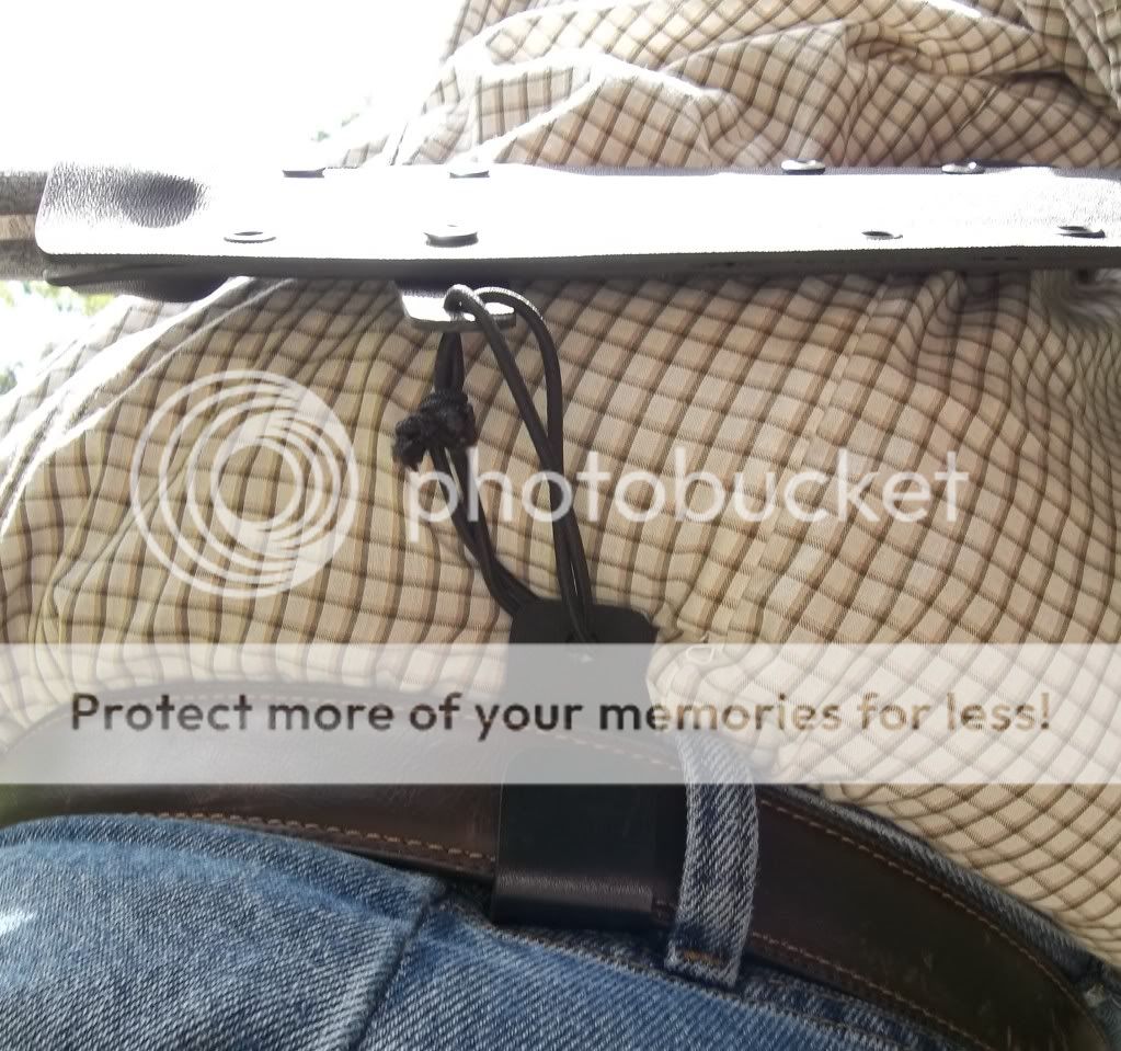

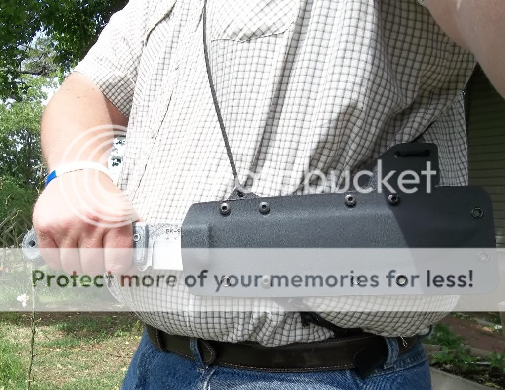

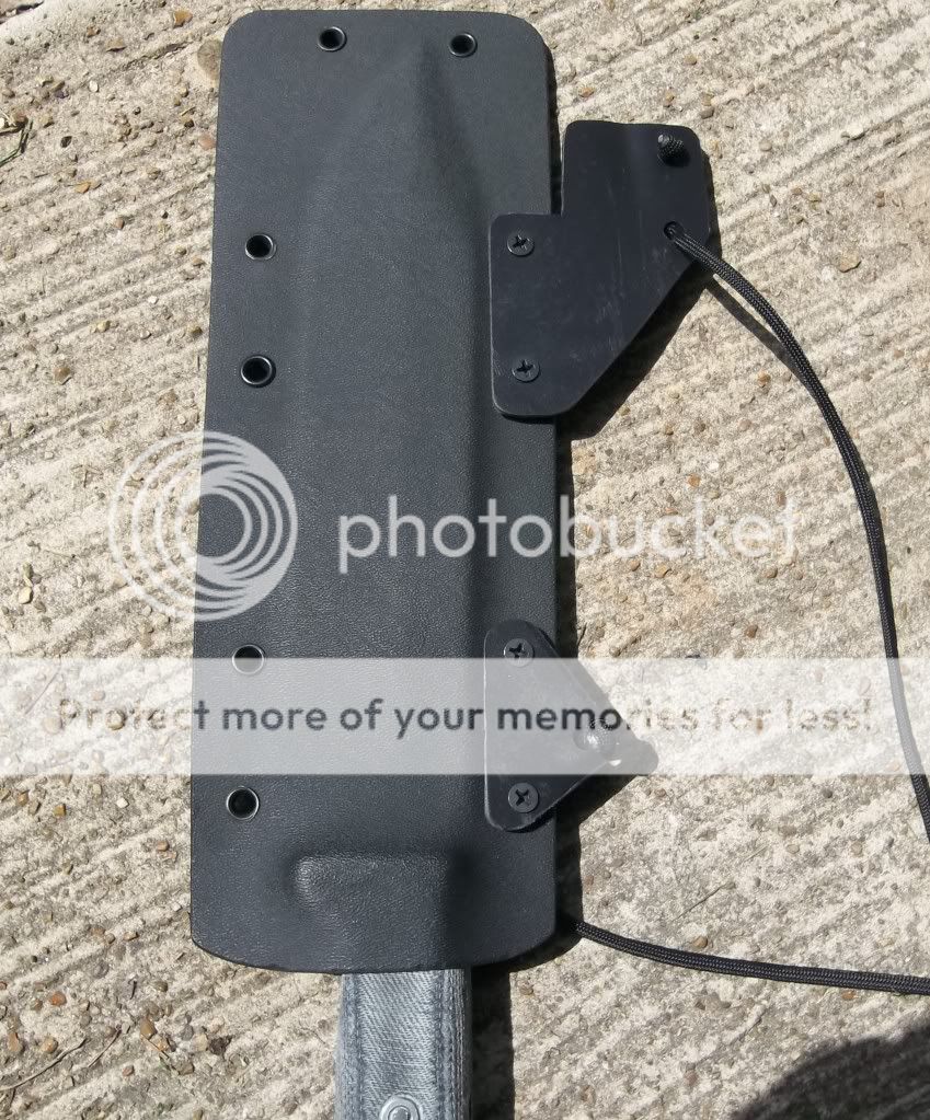

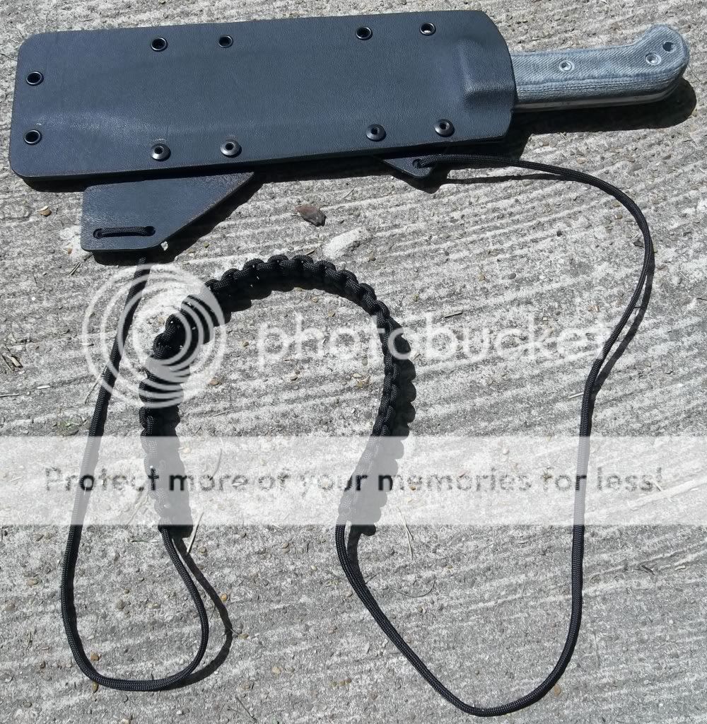

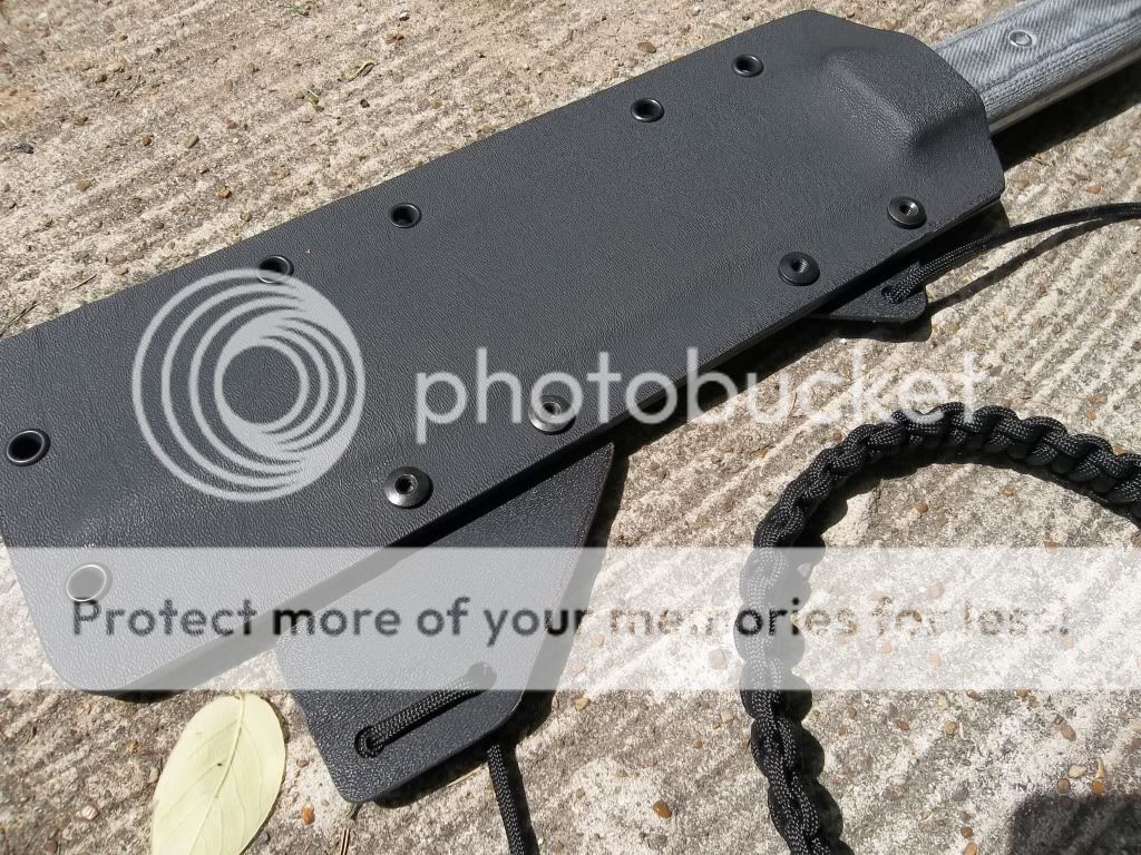

Rigged a belt clip with some shock-cord ran to the bottom of the sheath

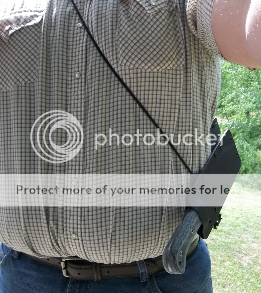

Works well, doesn't interfere with access to my jean pockets..(I hate crap blocking my pockets) and is almost scary how quick and effortless a ''quickdraw'' is from this position with the belt clip added! It's a lil ''mall-ninjaish'' for my taste..but it has practical applications.
It's very stable while moving, doesn't flop and bang around when walking, can stoop and lean without it swaying out from my body.
Everything is attached with two piece screw set & silencers from MOLLE locks..so I can easily remove it all from sheath and reinstall it without any adjustments or redoing of knots.

I usually carry crossdraw, I shoot with either hand so I like to be able to draw with either hand. By moving the belt clip closer to small-of-back, I can adjust where the knife hangs. I can go all the way around where the blade is laying against my back if I want. Or turn it over so the handle is to my right side.
