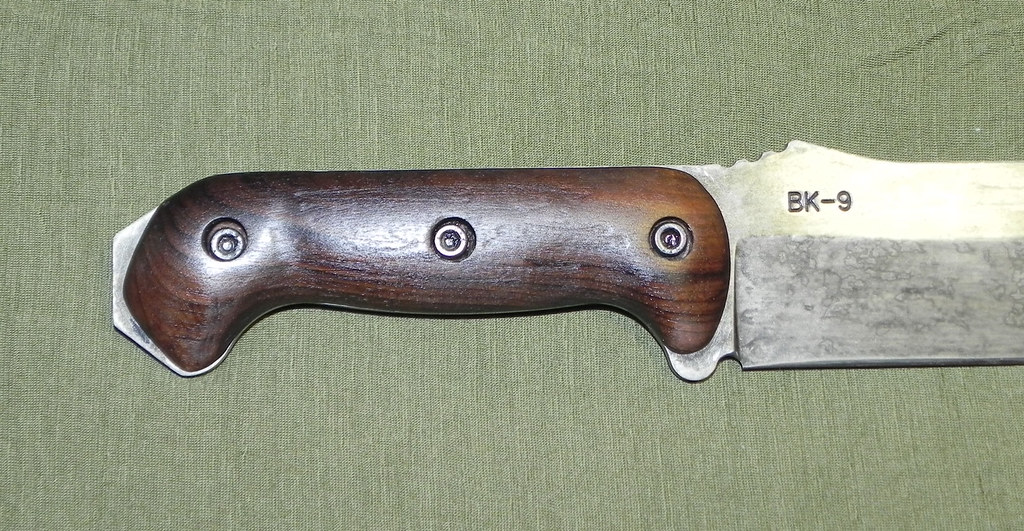

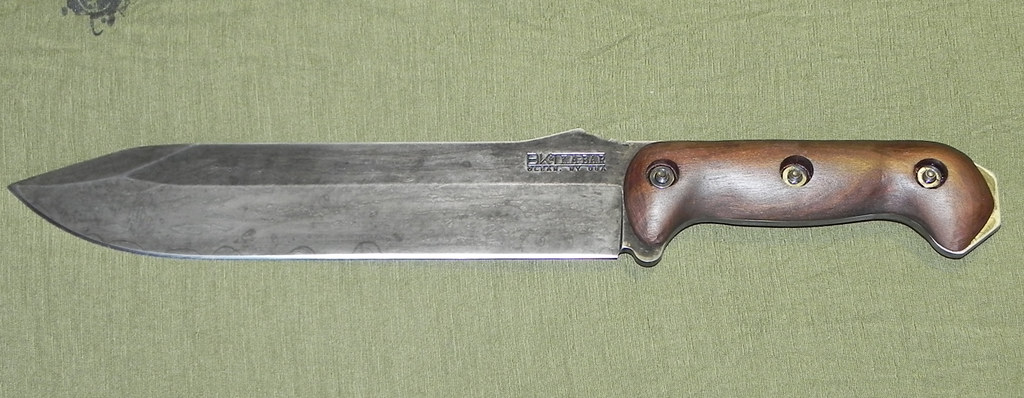

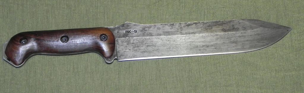

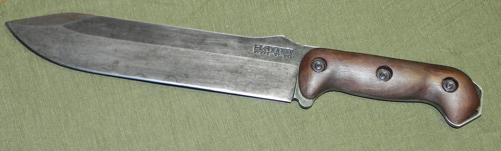

Just my first attempt on modding the knife that is becoming one of my all time favorites...
I made some wooden scales from a 30+ year old seasoned walnut, given to me by a friend a music instrument maker. I finished it with boiled linseed oil and beeswax. (Raw linseed oil witch I boiled with wax).However, I could not polish the scales.
I stripped the blade and added some patina. (mustard-lemon-vinegar solution).
I dropped the clip a little bit and put a convex edge on it.
Its far from perfect, with some major defaults on the scales. However, its an excellent sturdy knife, extremely usable and it has a bit of me embedded in it, so....
I am also waiting for some wooden scales from a renowned BF member, who was kind enough to make me some great scales (judging from his other work)
Hope you like it, but I would appreciate even more some constructive criticism, for my next project.
George
PS the pictures I took are not that great. I think it looks better up-close. Difficult thing photography.
