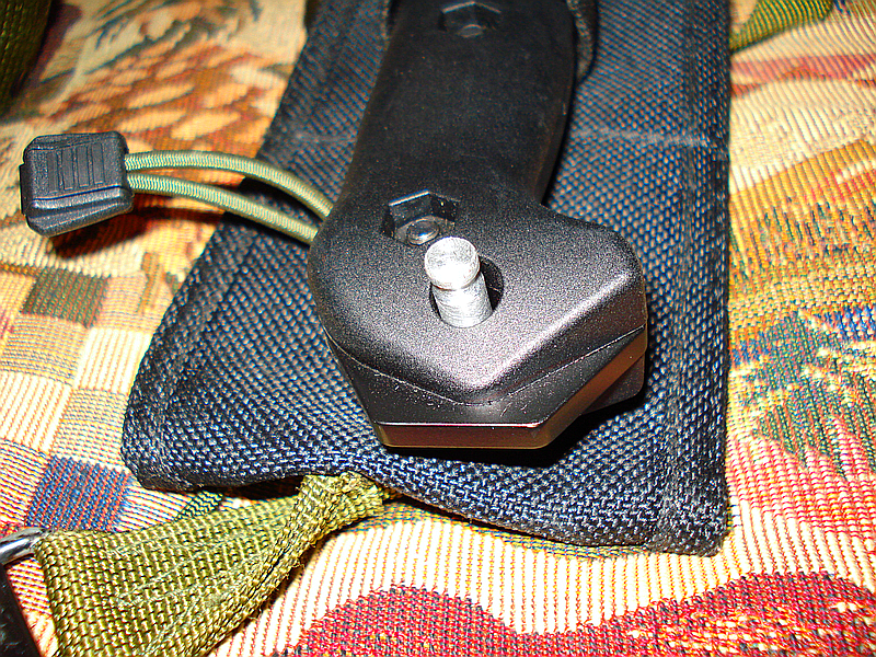

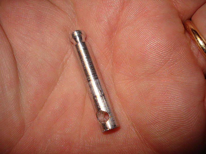

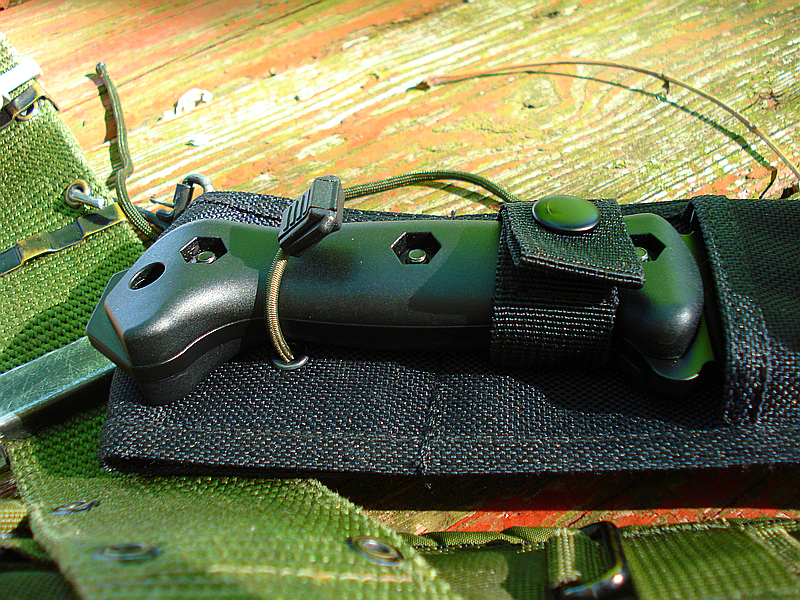

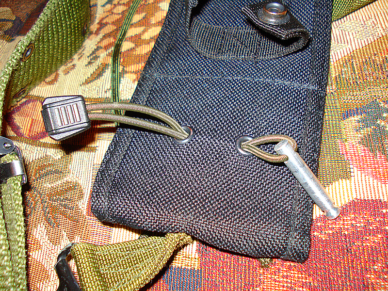

Took a length of 1/4" aluminum rod, drilled a hole in one end, and made a notch in the other:

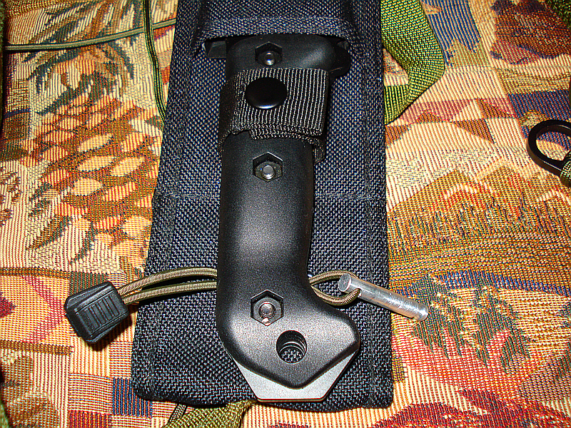

Ran some 1/8" shock cord through the hole in the aluminum piece, then took both ends, ran them in, then out of the eyelets, and attached an end to it:

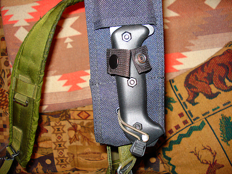

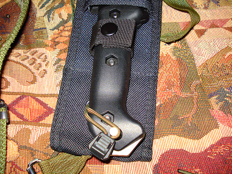

Put the 9 back in the sheath, and snap the main keeper strap:

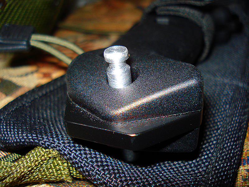

Place the aluminum rod up through the lanyard hole like so:

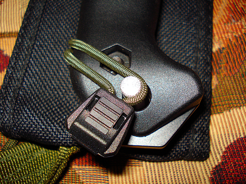

Pull the other end of the shock cord over the aluminum rod, and into the groove:
Held it upside down, main keeper undone, and shook the hell out of it. Didn't even budge:
This system works very well. Of course, the draw backs are that it isn't the fastest in the world to undo. Also, you can't have a lanyard in place. My solution for that is to simply keep some 550 cord, and a cord lock in the sheath's tin. It only takes a few seconds to put in.

Thanks Derek. It was easy to make. I wrote in the OP, that it was slow undoing, but it really isn't at all. I can undo it quite quickly, all with one hand. I can also re sheath it one hand, and snap the main keeper, but it does take 2 hands to put the pin back in, and pull the cord over it.
