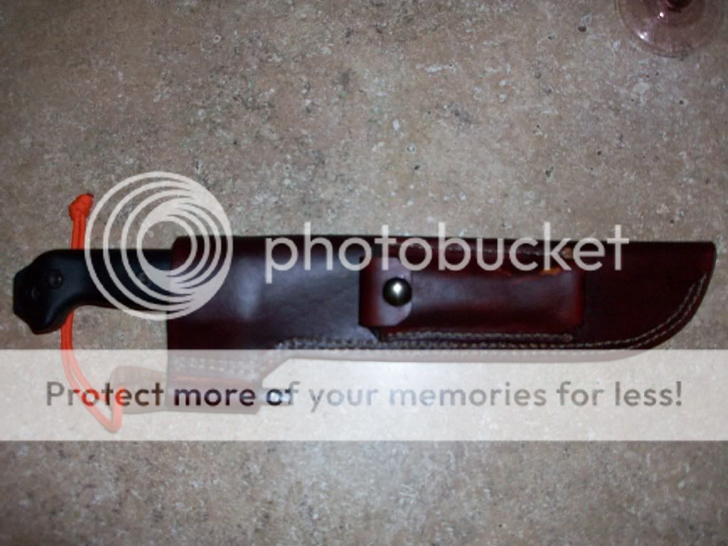

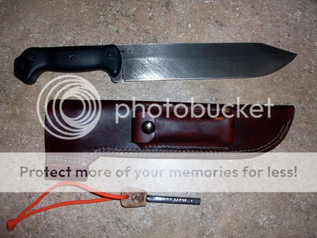

I got a local customer that wanted a BK9 M1 with a firesteel loop and a pouch for a DMT hone. Here's what he got. Its 12/13oz should cut leather:eek:, double stitched, waterproof inside and out, formed to a BK9, and tougher than any other sheath I have made, by far. The whole leather weight mixup has thrown a MAJOR wrench in the works. My customers that had standing orders get a boon, good for them, not for me. No additional charge for the thicker leather, but any new orders that come in, there will be a surcharge. At the firesteel loop, the sheath measure 7/8" thick, 4 layers there. Stitching this beast took over 2 hrs, and some very bruised thumbs and fingers, and 2 broken needles.:eek:
On average, my BK9 sheaths have about 130 stitches, but with the addition of the pouch, it got bumped up to 160. Three layer of this leather, is nearly 3/4" thick. My fingers hurt just typing that. :D:thumbup:

may not want that much cordage on the fire steel - may get hung up in vegetation and pulled out of sheath

LMAO, thanks, but that my around the house, sheath fitting firesteel. My last count of the ones I have are 26, of various sizes. Thats one of 7 Rough Rider steels I got laying around.
I'll remember that, and shorten them up, but I use shock cord around my firesteels That head to the woods with me.

are you sewing while the leather is still wet from forming?
if not, try that - I find that it helps me when I'm sewing multiple layers of 10oz or thicker.
(used to do a lot with 13-15 oz saddle skirting -- that stuff is brutal!)
