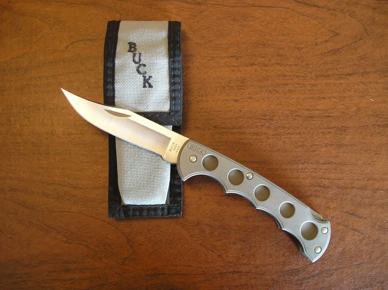

Here is a photo of mine, which is dated 1988. It's the original version. I'm trying to determine if there is a difference between it and the "gray" version that came out later. Perhaps Dick will see this and reply. The photo makes it look lighter than it is. The real thing is darker and has a brushed finish with the brushing running from front to back. I would say that yours is like mine and therefore an earlier version. (Of course that implies that the "gray" version is different.
Yours is quite different from mine; mine has only a beveled edge, while yours has the same "step" as the 186...I'd guess Buck simplified the machining process as time went on...which might make mine one of the later variations...
Maybe the original owner of mine can shed some light on this...[coff,coff]... :p
Edit: Yours doesn't seem to have the bevels in the holes, does it???
Trax,
After examining your 560, I agree. Mine has only a very slight bevel at teh top of the holes and has a stepped edge identical to the 186, in fact, it's the same knife minus the clip.
Mike
