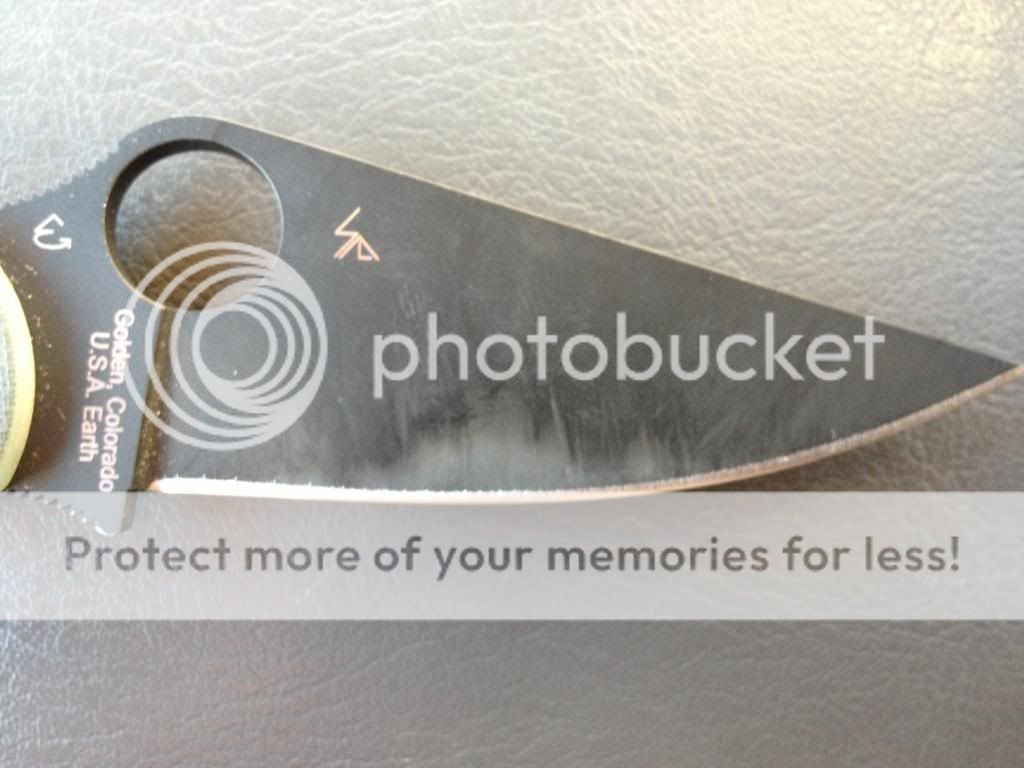

Before
After
jon1all , that before and after pic set is great. It really does look like new condition after you cleaned it. What does it take to get results like that ?
Believe it or not, just some soap & water followed by a light coat of mineral oil on the blade after drying it off.
