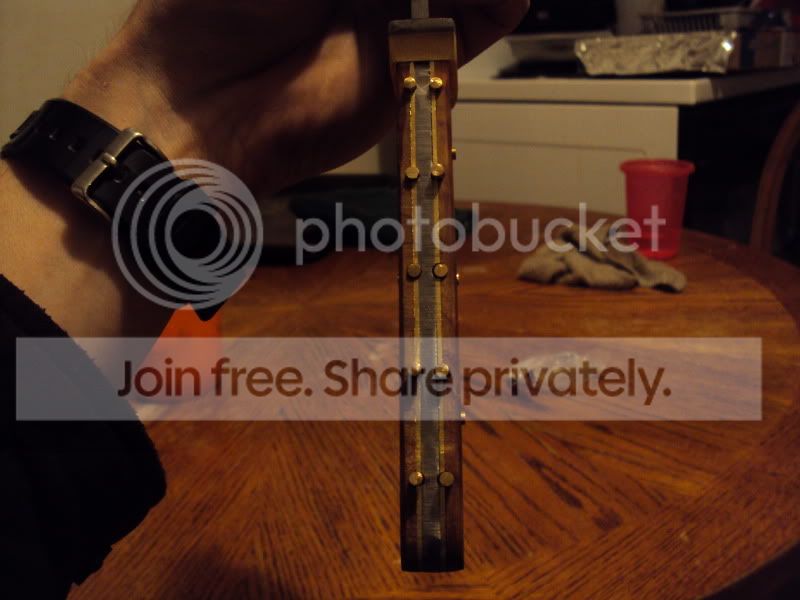

I have no experience with a black handle so I could use some advise. I have a knife I have been working with for a while now and what I have come up with would look best with a solid black handle I think. I would like a material that will shine like black marble so what would you all recommend? African Blackwood, G10, Micarta, a piece of dyed black wood?? It has to finish to a high gloss like marble or a real fancy paint job on a car, I would like to see a reflection in it if possible.
It is going to be this handle with all the brass, I think black would just look really good with the brass.

Water Buffalo horn is black and gets really shiny when polished. It does have light streaks in it though. Not pure black.
Buffalo horn or Corian are the first two things that come to mind. Stabilized wood should buff to a higher gloss than unstabilized.

I used black paper micarta and finished it with light layers of spar varnish and polished each layer. Very high gloss. Im going to try ebony next.
I'll second the buffalo horn or corian ideas.
If you want a natural wood, african blackwood would probably be the best choice.
G-10 or micarta might work too but need to be taken to the highest grit possible to get the most out of it. Even then you can still see the 'grain' in it. It's not really pure black.
