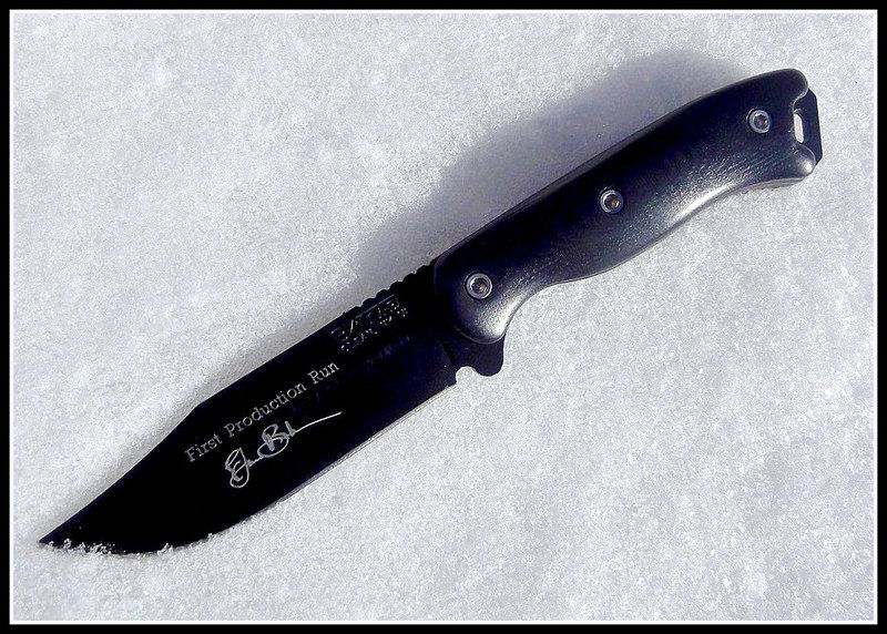

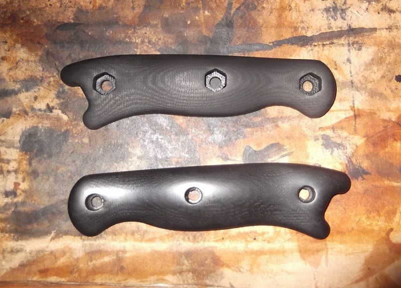

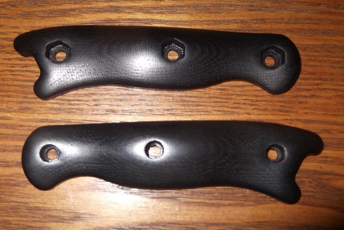

I have been trying to get the nerve up to try this for a couple years. Finally gave it a go. I like it.
I used fiebings oil dye and waxed them with bees wax.
One before and one after waxing.
Finished and ready to bolt on.
Done
