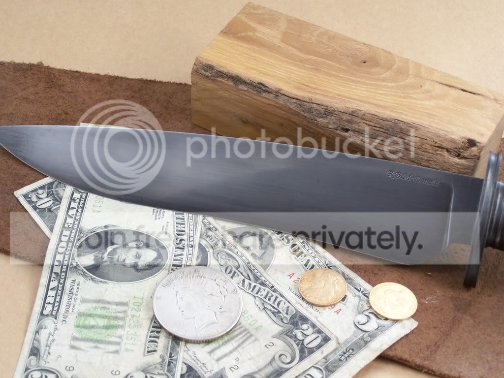

This is one I did with Caswell's product.
