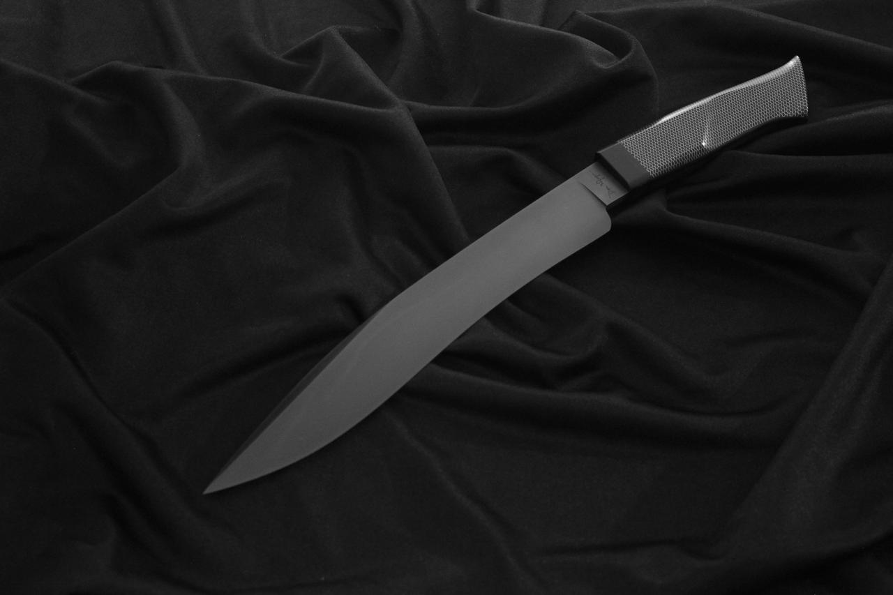

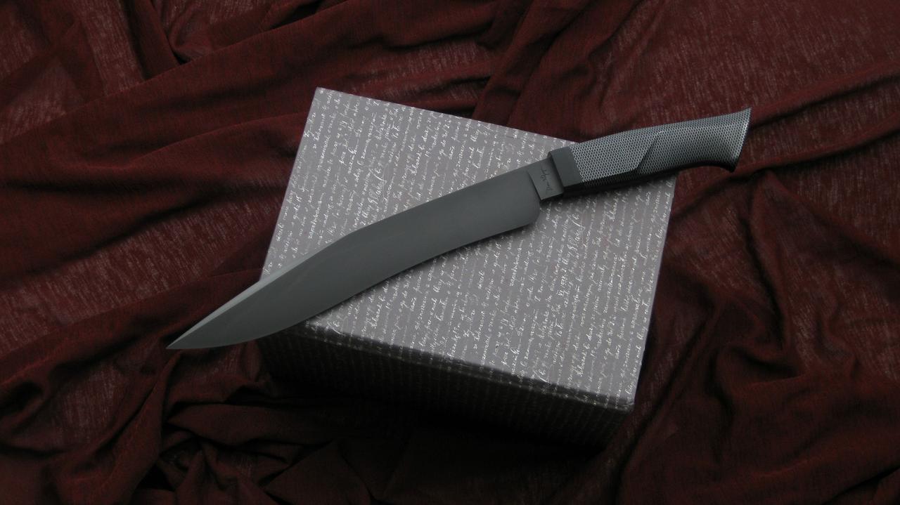

This year I spent a good amount of time working on an experimental knife for the bladesmithing competition at TMS 2015. The requirements were that it needed to be forged and also needed a video, characterization report, and poster. I attempted to do a chopper of 52100 with a martensite edge and a martensite/bainite duplex spine.
Unfortunately I didn't place in the competition, but I learned a lot and will improve a ton from it. It also made a big impression, which is what I wanted at the very least. I want to thank Aldo for 52100, Chuck Bybee for the C-Tek, Travis Wuertz for forge access and materials, and Sonia at Tempil for a series of Tempilstiks.
Finished Knife:

Don, did you do something to "reinforce" the black etch on the blade, or just etched in ferric? Somewhere i read they go from the ferric to boiling in caustic solution to make the black oxide more permanent; did you do something on this line?

I just did a straight etch on it. I'll have to read up on the extra treatments!

Looks real nice. The handle looks like it has a right angle near the bolster, does that create kind of a hot spot when cutting?

Paul, the Tempilstiks were for gauging temperature when I did the interrupted quenches. I needed to know when to take the blade out of the initial quench and onto the next since I was trying a relatively complex and experimental procedure (to me at least). I found that once the quench stops gurgling it's at 650° F; if I took it out any earlier it would flare (learned the hard way).
Overall the handle isn't bad, there aren't hot spots but there are definitely adjustments I'd make for the next. Making these handles are not easy, and I have much respect for the guys who do the really nice contoured handles.

That was the basic idea. The temperature drops after taking it out of the quench were actually pretty slow. I could hold it at above 400° F for probably a minute just in still air. The important part of it for me was to ensure that the spine never dropped below the martensite start temperature. By the time I'm done with the second quench the body of the blade is still at above 500° F.
This could be a very ghetto method to get what I wanted, but at the same time it was just a Frankenstein'ed experiment I've always wanted to try out :)
