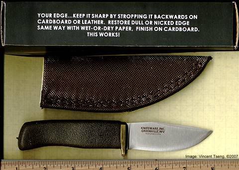

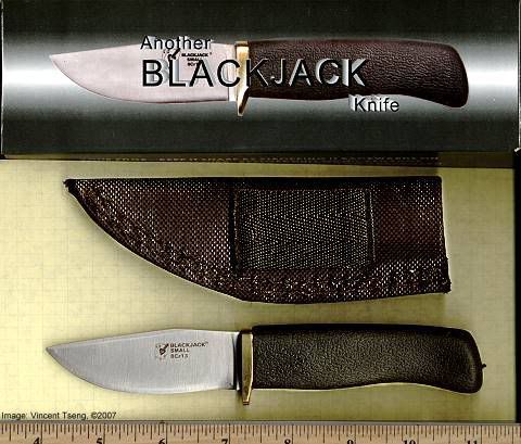

I picked up a BlackJack Small with Kraton handle at the Blade Show from Ken Warner's BlackJack table - they were priced at $33 - this ia s pretty good price for a well designed knife with a full convexed edge.
As some may know I was very impressed with the Colobolo handled stainless steel BlackJack Small I bought from Ken Warner also at a Blade Show 2 years ago - this has become one of my favorite fixed blades
Please see BlackJack "Small" select Cocobolo stainless.

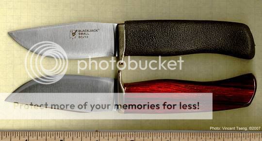

So I compared them -
The Kraton Small is made in China with 8CR13 (some Chinese stainless steel), and comes with a nylon sheath
The Cocobolo is made in Seki, Japan with AUS10, and comes with a leather sheath.
The Cocobolo is pretty - I actually selected it out of several -
What other differences are there?
Hard to see from just photos -

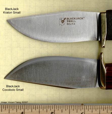

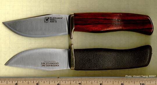

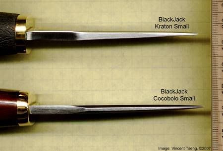

Kraton upper, Cocobolo lower.

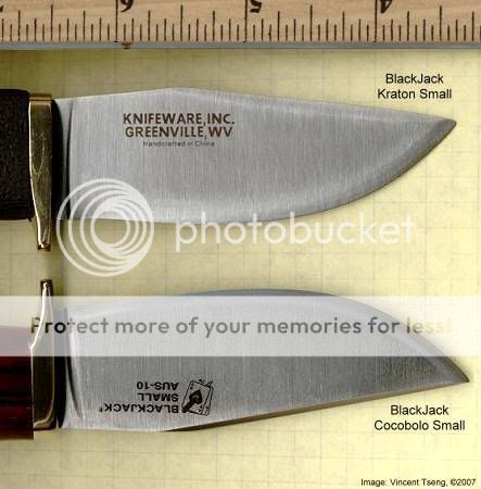

The Cocobolo Small is much thinner toward the edge than the Kraton -
they are both, strictly speaking, flat ground with continuous convex bevel edge.
The continuous convex "bevel" is much narrower on the cocobolo as can be seen in the photo - showing that it is much thinner toward the edge than the Kraton.
What does this mean - since both edges are full convex?

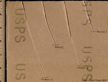

The ability to cut through is affected. The thinner edge should cut through better as shown in my ad-hoc cutting of corrugated cardboard -
This is only a casual and informal test, and not that well controlled.
I merely did two pairs of cuts - trying to cut the same way with both knives.
As can be seen, I was not that consistent between the the two separate pairs - but in both cases the depth cut by the cocobolo Small with significantly better than the Kraton. I could actually feel the difference.
So my Kraton Small is not as good as my Cocobolo Small.
I consider my BlackJack cocobolo Small one of the best fixed blades I have
- whereas the Kraton Small is good value and merely a good "knock-about" knife.

Good comparision, Vincent ! What are the blade thickness at the spine of the two models, if I might ask.
Are you still enjoying the Cocobolo model .....is it mainly for dressing game and such ?
-regards
Thanks for the kind words.
They look to be the same stock thickness.
There is a slight trick to the photo - the Kraton Small may on first sight look thicker - but its upper "false edge" is just not ground back as far/much as the cocobolo Small.
