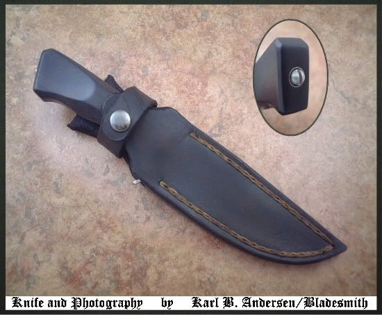

I wanted to add the sheath photo and the take-down assembly

The most frequent area of wear on guns, knives, etc., is on sharp, leading edges like the barrel face, front edge of cylinders, edge of guard, etc.
Notice on my knives how I dramatically round over the outside edge of my guard. I only leave about 3/32" of the face flat, right at the blade.
I do this for four reasons:
1.) I do NOT like squared off flat faced guards on working-sized knives. I'll admit it makes a nice "canvas" for inlays, engraving, etc., but I just don't like 'em.
2.) This rounded over profile actually acts like a "guide" when the knife is placed into its sheath - there is no leading sharp edge to catch on the sheath.
3.) Since I do a LOT of hot-bluing on my guards, this rounded over area does not lead to any excessive wear.
and 4.) I make a choil area for choking up with the forefinger on my working knives, and this smooth rounded over edge facilitates that grip without an uncomfortable edge.
I did this one in stainless 'cause I do like contrast in my guards/handles.
