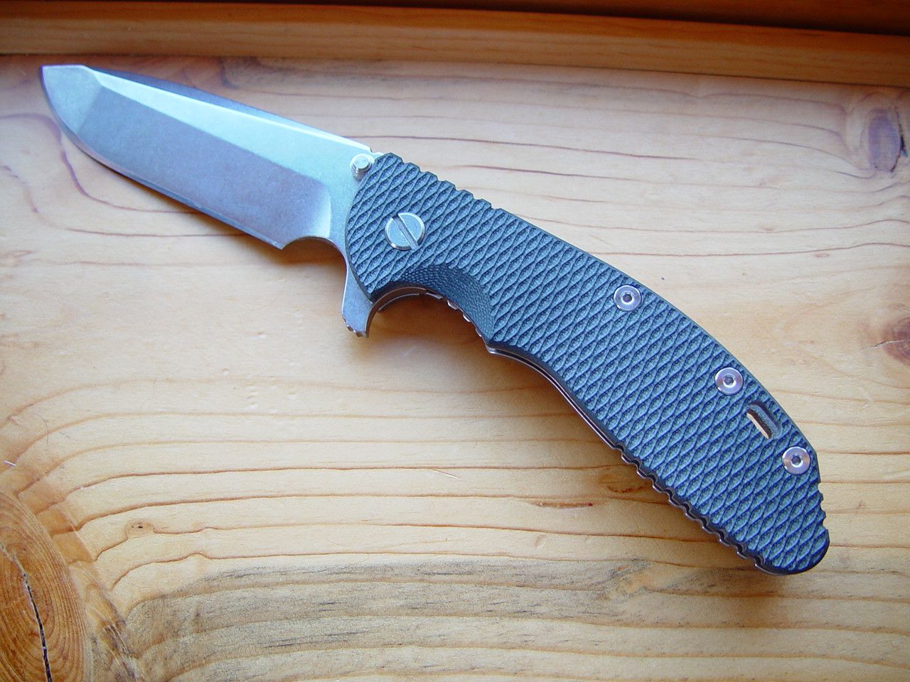

Thanks again for all the suggestions, the blade seems centered nice, she has been on the wicked edge and is nice and sharp. Thanks to MODiFiEDZ for the nice video on the Wicked Edge, great video!! SO I thought I would post a few pics of the knife and my only other Hinderer.
The knife

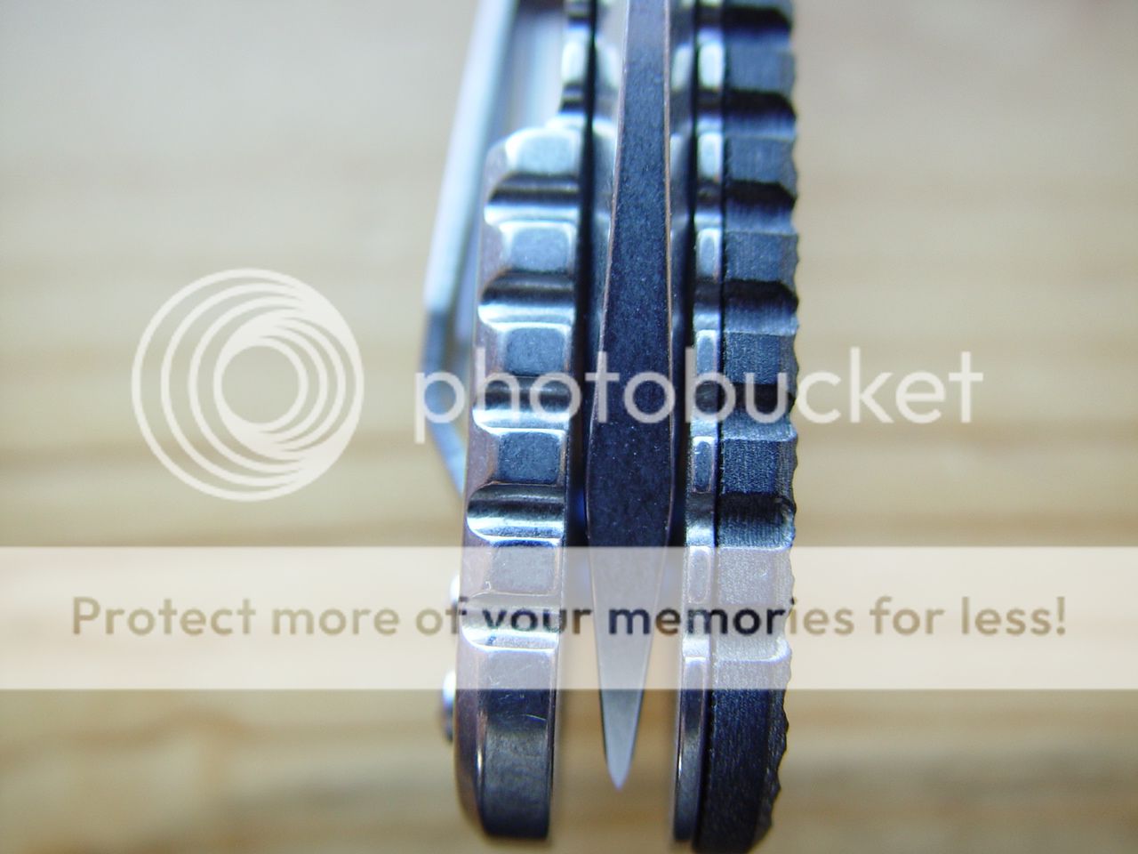

Centering

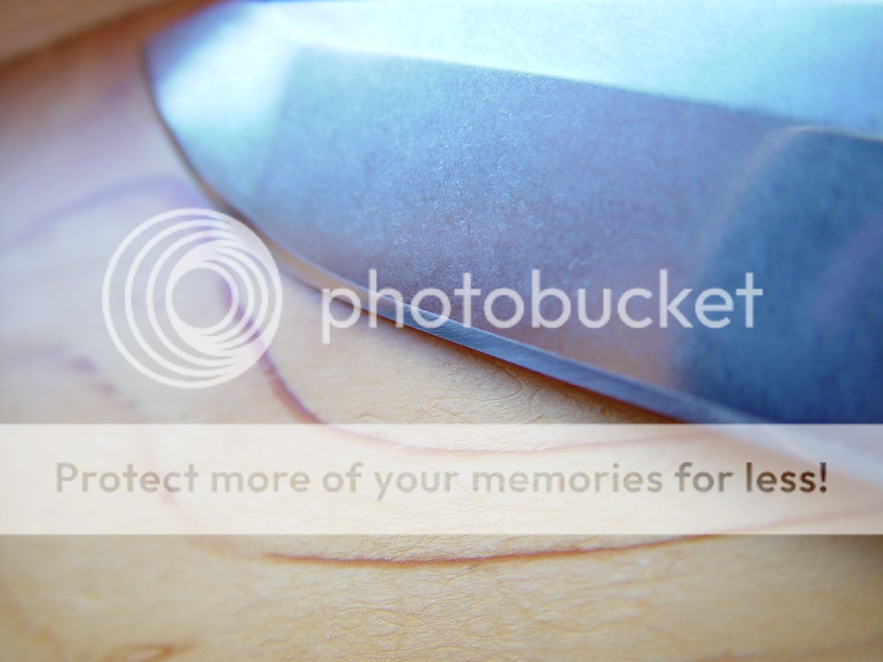

The edge

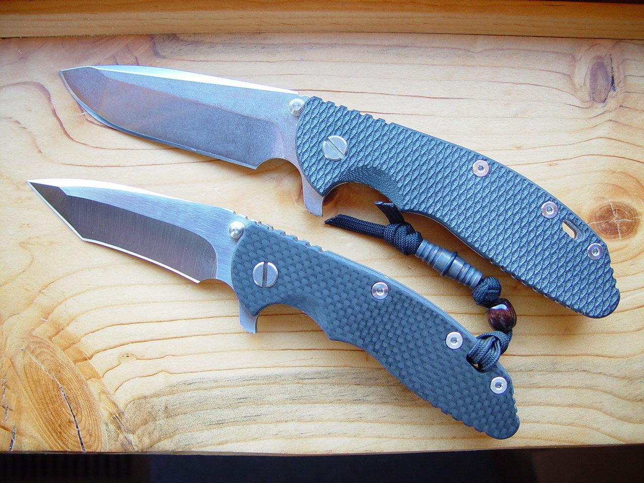

My 2 Hinderer's
