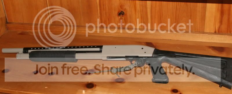

Another Duracoat example, this shotgun was lightly sanded with 400 grit, and sprayed in coyote brown (IIRC) with a preval aerosol sprayer:
