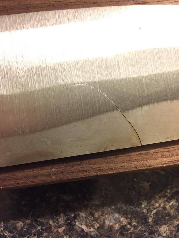

Hi all,
I was grinding a blade earlier today, when it developed a pretty big crack at the spine of the blade.
Is this normal, or is there anything I can do to avoid this? I wasn't doing anything crazy with the blade, it was .110 thick Nitro-V stock that had been heat treated by Peter's.
Here is an image of the crack
I have seen that happen and it's happened to me befor but normaly becaus it was not tempered befor grinding. Befor tempering there is a ton of stress in the blade waiting to be released and once you start grinding away steel the stress goes out of blalnce and you get a crack. But if was heat treated by peaters so I'm not sure. It would be worth running a hardness test on that blade to see how hard it is.
We need to know the steel type, HT method, tempering specs, and when in grinding the crack happened.
Hi,
Thanks for the replies, it was a piece of .110 Nitro-V that I had sent off to Peter's to be heat-treated to 62 HRC.
I was trying out something I had read on the forums here, where someone had used a contact wheel to hog off most of the steel before flat grinding (That is why there are a bunch of stacked grind marks on the blade).
I was dipping the blade after every pass, so the blade wasn't getting too hot, I am still new to knifemaking in general but I don't think I was doing anything out of the ordinary
I've only had a crack show up during grinding that was already there, but I didn't see it at first. Nothing major like that though.
I recently got my blades back from Peters' and I found a couple of the blades with a crack; one NitroV blade the spine and another NitroV blade with a surface crack. Both were about 70% pre-heat treat ground and I didn't touch them since I sent them out for HT. I found the cracks today and searched to web to see if this is a common issue, found this post and decided to reply. I'll post pics later when I can.

I also got a bunk order of A2 from them. Out of 9' of the stuff, I was only able to salvage 2 blades. Everyone had cracks.
A2 is the steel I use the most. I've never had an issue until this order. I purchased some from AKS and no cracks.
All sales final at NJSB. I just tell myself the $500 approx bunk A2 was just a bad trip to the casino.
This is weird. A2 is normally really stable and I always look forward to heat treating it. I hope the nitro-v cracks where just a fluke. I'm talking to a potential HT customer that has 20 nitro-v blades. I have only had AEB-L black once and that was because it had such a crazy bow. Like crazy bad and we lost it during tempering while trying to straighten it. Hope this is figured out, nitro-v sounds like it has good potential.
Likely that the bad batch of A2 wasn't rolled at a hot enough temperature. Thats what Edward Braun told me.
