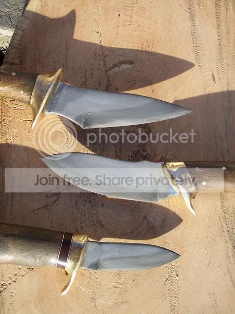

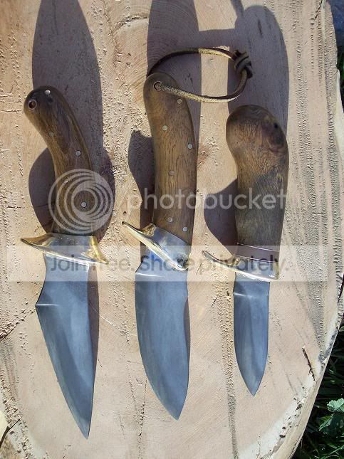

Finaly found a RadioShack 'full' of Ferric Chloride , so dipped a few blades, and think I have more questions then answers now.
What am I looking at, I see the transession lines, but maybe just don't understand what the enchant dose.
The blades are 52100 and have been deferentially quenched 3 times and tempered 3 times for 2 hours each draw.
The Perch-Belly blade will out cut the others by nearly twice in 3/4" manila rope and seems to hold the best edge, I blame that mistake on forging it from a bigger stock.
Personaly pleased with the results, just hoping to understand the proses better?
Thanks in advance!
You have tootsite or tempered martensite, below the "temper" line and the softer steel structures above. The acid etches them differently. Cut the ferric
chloride 3 to 1 with water. It works better. Also the hardened steel is etched quicker than the softer parts. If you leave it in for an extended time it will really show.

Fred,It's called troosite. It is the border between the softer Pearlite and harder Martensite,and as Fred said, is tempered martensite. Troosite etches darker than the fully hardened martensite,and shows the line sharply against the grayer pearlite. In a true hamon the ghostly line is a mixture of both structures.
Neutralize FeCl with windex.

What these guys are saying is what's happening. Just a thought though, my experiance with 52100 has never given me the clear transition lines that your show. IMHO, 52100 requires you to hit the heat treat right on the money or you won't get the desired quality blade. That may be the reason the one blade seems much better.
