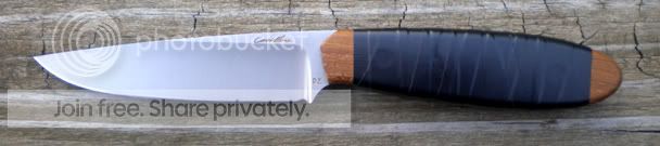

Here ya go Rick, your new knife:
It is made of a reject blade and some reject scales. I stuck the scales on with electrical tape for nice ghetto look for you (look out Charlie Mike). In retrospect, a couple drops of super glue would have been a better idea...
It is D2 at HRC 61, with a HT optimized to improve D2's poor fine edge stability. You might be surprised how well this geometry cuts things like cardboard and meat and still tolerates bone and hard clacks against a cutting board etc.
I've done a lot of experimenting with this steel and pattern.
