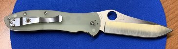

I ordered graphite colored RIT dye today. I saw a thread on the Spyderco forums where a guy used it to dye all of his jade/DLC M4 spydies and they have a smoke/transparent gray color that looks fantastic. Aftermarket clip will be added tonight when I get home.6390A1D4-CAE2-4C6F-8D02-CF3B9245ECF5.jpeg1197AB9D-EECB-4B1C-AE33-6FDF4964F308.jpeg7A4EDBB8-78D3-407F-885D-3C969E9937A8.jpeg

Looks great. How long did you leave it in the dye to achieve that color?
Probably 15 minutes or so. I pulled it every 2-3 min to check and at 10ish it seemed too light. At 15 its a little darker than I wanted. Im thinking it may fade/wear a bit from carry. I also think it seems darker on the knife, maybe because the back is covered when assembled. If I do it to my other one I will stop it at 10 no matter what. Also I eyeballed the dye to water ratio. Probably should have measured
