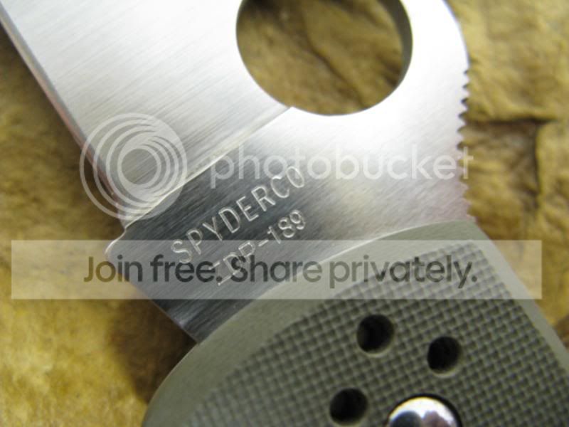

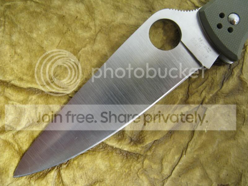

Yes this is a Krein'ed ZDP G-10 Endura :eek:
