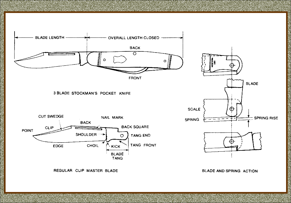

"Choil" is the point of transition between cutting edge and ricasso, basically where the plunge/grind terminates. It is necessarily (by definition) part of the blade and located where the cutting edge stops, so a difference in size/design between a choil-notch and a finger-choil and a "choil-less" (really a notch-less) transition necessarily impacts the length of the cutting edge. Similarly, the "ricasso" is the unbeveled part of the blade nearest the handle, so a large ricasso also impacts length of the cutting-edge. Many choil-notches are cut 50/50 into edge/ricasso, although some are cut entirely in the edge. A notch/groove cut only in the ricasso is not actually a choil-notch/groove at all since it does not touch the edge-grind. An excellent example of this is the Spyderco CalyIII, where the edge terminates at the ricasso (choil) without a notch, and then a finger-groove is cut in the ricasso such that there is an intergral guard before the choil and cutting edge.

I HATE choils or long ricassos.. Don't know about the choil definition above as I was always told it was the finger notch(??) between blade and handle... Takes away from blade cutting edge in my world!!! JMO!!! John
...Don't know about the choil definition above as I was always told it was the finger notch(??) between blade and handle...
It's a common confusion brought about by the relatively recent popularity of larger choils designed to accommodate a finger. Nowadays you'll hear folk call ANY groove ANYwhere on a knife (or even the sheath) a "choil", but "choil" has never meant "groove" or even "notch"
