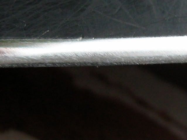

I do a lot of finishing on an un-lapped Spyderco UF and I can tell you while the polish is very close to that in knifenut's pics it just isn't quite there. The polish does appear finer from a lapped UF.

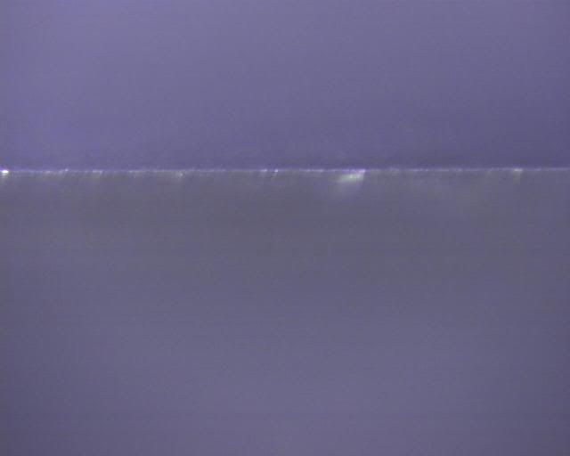

How do you think Sal first started making the UF stone? If lapping it had no effect then the UF stone would have never been made.
The pictures are to show what a lapped UF ceramic can do. This next picture shows the finish of a un-lapped UF stone.
This is a 400x pic of the edge of the mini-rukus above, no stropping just the stone.
Here is the results I got before lapping. Not as close up but it doesn't need to be.
How can I say that? Because it is true. Lapping an abrasive doesn't alter the grit size. It just smooths the surface. It just cuts the tops off of the abrasive grits. The result can't physically cut better. Science says it can't work that way.

I'm not showing pic's to show my sharpening ability I'm showing them to show the difference that the stone has produced. The stone IS sharpening by removing metal not burnishing, otherwise it would not look like this.
Side 1
Side 2, the ultra ultra fine side.
Side 1
