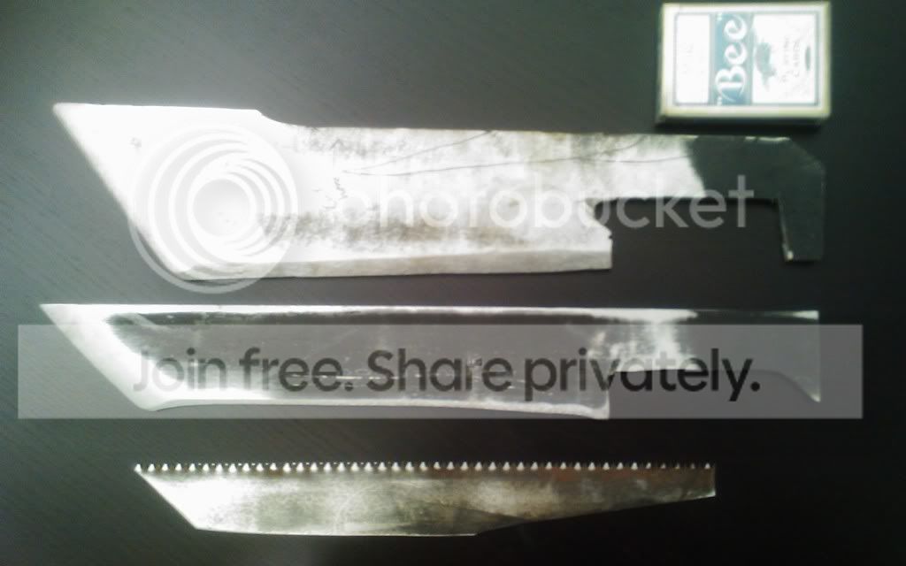

I bought some o1 steel bars from the my local metal shop (BTW I am in HK) and started on my 2 Machetes projects (Stock removal) last Sunday.
I have completed profiling the rough shape of my 2 heavy duty Tanto machetes.
18" X 4" X 8mm of "HEAVY" Duty O1 Machete, weighing at nearly 5lbs
18"X 2.5" X 6mm of "Lighter" version of Heavy Duty O1 Blade. Much lighter weighing at around 2.5lbs

1. After cutting out the rough shape of my blades, i saw many jiggy point on the handle. Since they are in tight corners, my power tools can't get in the space to smooth them out. What kind of tools should i use to clean up these sharp jiggy edges??
2. I have use a #80 sandpaper to remove the blacken tar like finishing on my knifes. However, i saw many many tiny pits on the steel after removing the tar. Is there any way to remove it?? can they be smooth out by sandpaper?
3. Heat-treating , i plan to use my Charcoal BBQ grill + hairdryer attachment for the hardening process. I bought a Laser digital thermometer for reading the Temp of the blade while it is burning.

Don't brine quench O1. Oil is needed. O1 needs a medium speed oil. Canola or peanut oil would probably work.
Make sure your laser thermometer can read temps up to 1500F. Most stop a good bit short of that, but there are more expensive lasers that can measure that high. Otherwise, keep a long-reach magnet hand and check the blade frequently to see when it looses magnetism. This will be somewhere around 1414F. You need to heat a bit past that. If you can do it when it's dark, watch for very faint shadows that will seem to dance in the glowing steel. As they fade away, you're in the neighborhood of the correct temperature. That's a very rough way to heat treat, especially for O1, but it will get you some hardness out of the blade, but not the best that the steel can provide. O1 needs more accurate temperature controls than you'll be able to achieve to get the best results.
The pitting is a normal extension of that discoloration you sanded off. I consider it to be part of the mill scale, and it should be removed, but it can be very tough. You can use a hand file to smooth the edges and also to remove the mill scale. Search for draw filing and try it out to removing the pitting.

Hi. First of all welcome to blade forums! You didn't say if these are your first blades or not but, no, don't quench in brine. Your blade would break if you did because it would cool it way too fast. Oil is what you want.
O1 is a great blade steel. As silver_pilate said, check it often in the fire until it looses it's magnetism (is that a word?) and then let it soak for another minute or so.
1. Hand files or your rotary tool or plain old sandpaper are what you'll need.
2. Not sure what black tar like stuff you're referring to but, I'm imagining something like fire scale? Anyway, yes sandpaper and a sanding block is how I would get the pits out.
3. Veg or canola oil for sure. Pre-heat it to about 130 degrees F. It shouldn't flare up too bad, if at all. If it does, don't panic, just simply put some kind of lid over the container and it will go out.

O1 shouldn't make you nervous, it's not as likely as some to crack, though it may warp, especially on a long blade with uneven grinds. I wanted to make swords when I first started, everything I read said start small and work up. I'm on some large knives now, but nothing gigantic, I'm glad I started small.
With that equipment you'll spend many many days working on a sword and will probably not have a great time getting the grinds or finish you want. It's possible, of course, but not likely. Some folks on here like Chris Moss can be an inspiration, but then there's regular guys like me who spent 4 years working away with a belt sander and a dremel tool with nothing to show for it. I would suggest making at least one small knife and completely finishing it first, that way you know some of what large blades will entail. The BBQ is going to be a difficult way to heat treat your large blades, especially if you want the heat to stay even.
You can sand out all of your pits, it's going to take quite a while. You may want to draw file them first for heavy stock removal, or look into getting a cheap orbital sander and replacing the rubber backing with a hard plate. This will make removing any scale and pitting much easier.
I agree that you should oil quench that steel, but I doubt it will break on you if you brine quenched it unless you leave it rather thin and unevenly ground. Micro crack maybe, but I doubt it would pull apart in the quench.
You will want to get as much sanding a possible done before the HT. After the metal will be hard and much more difficult to sand or shape. I take it to at least 220 using water to wet sand with metal cutting paper.
hi guys
I just finished a very rough profiling. i will sand it down and some major touch up this weekend.
All comments are welcome.
