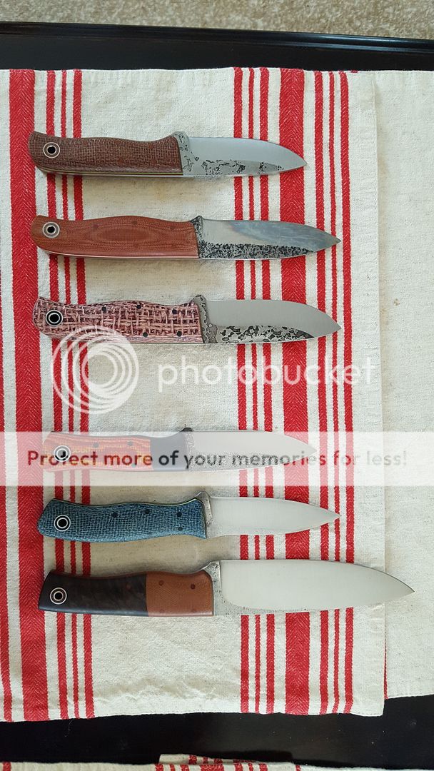

Pictures says it well, the three on the right are favorites. The Bush Hermit is a new arrival and was not in the pic. Odd how different each of the handles are but all are very comfortable.
L-R 3/32"; 1/8" TT & 5/32" TT
Bill
Nice collection.
Looks like you are consistent in choosing a drop point but vary the length. (The mid-sized blade with bluish scale might better be called a 'spear-point' I suppose.) Any particular reason for sticking with the drop point?
Nice collection.
Not nit picking just clarifying. Actually it, an Asp model, and the Arete, (second from the left if left is up at the top :) ) are what I think most consider spear points. May just be hard to tell at that angle.

I gravitate towards spear points and drop points that verge on spear points- different makers may lean a bit more this way or that blurring the lines.
The ASP is a major favorite in feel and function. The Duke is a wonderful "big" knife.
To be clear, I do not chop with my knives. I am an axe fanatic- either a machete or axe for chopping.
I DO baton my knives and have every confidence in the above profiles and thicknesses.
