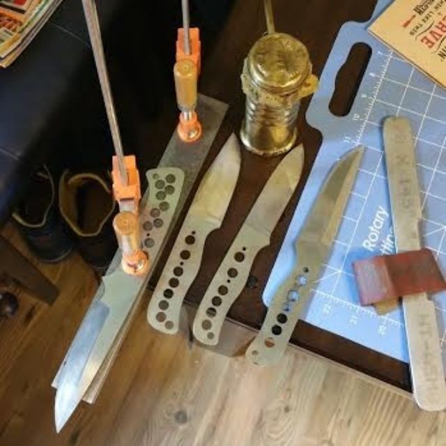

I already have 3 knife fully finish sanded and the blades taped up. They are a Bowie EDC in CPM 154, a Pocket Fighter in CPM 154, and a large Slicer in S110V. These will be getting wood scales.
In this picture is four more that I am working on right now.
The three on the left are CTS-XHP steel with tapered tangs and are going to have the flats hand finished.
The blade on the far right is a 1084 Fighter with tapered tang that I plan to fully hand sand to at least 600 and will be getting some very nice Ironwood Burl scales.

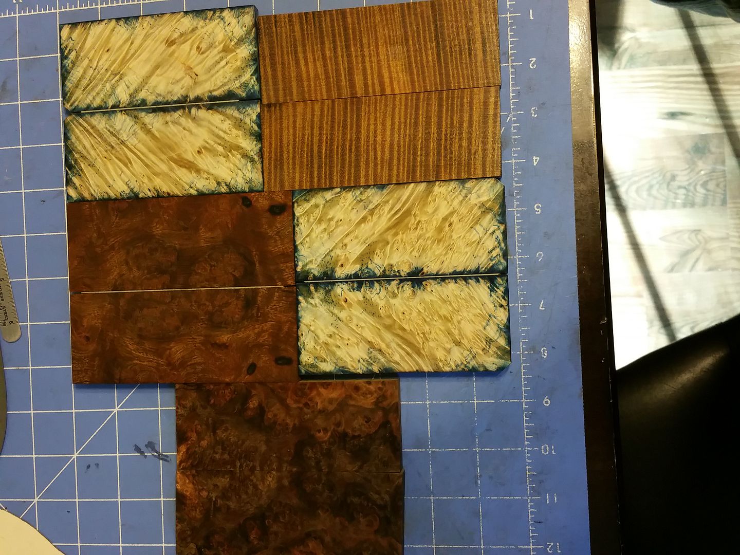

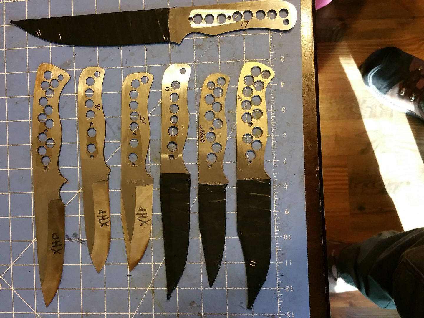

Here are a couple more pics.
One is some of the wood scales I have specifically for Blade Show knives, with a couple more sets not here yet.
The other picture is of a few of the blades post hand sanding waiting for scales to be installed.

sloth, that blade is the one at the top of the blades picture above. It has a 36" hollow ground primary grind and a 12" hollow ground swedge.
It is going to be getting the Gallery Grade Rosewood Burl scales at the bottom of that picture with red G10 liners.

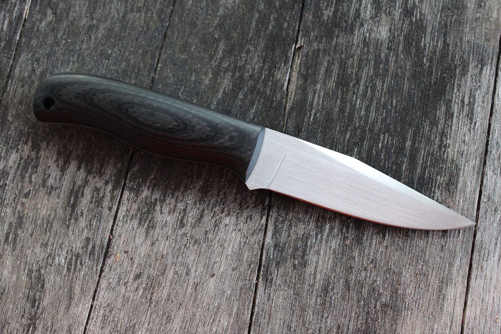

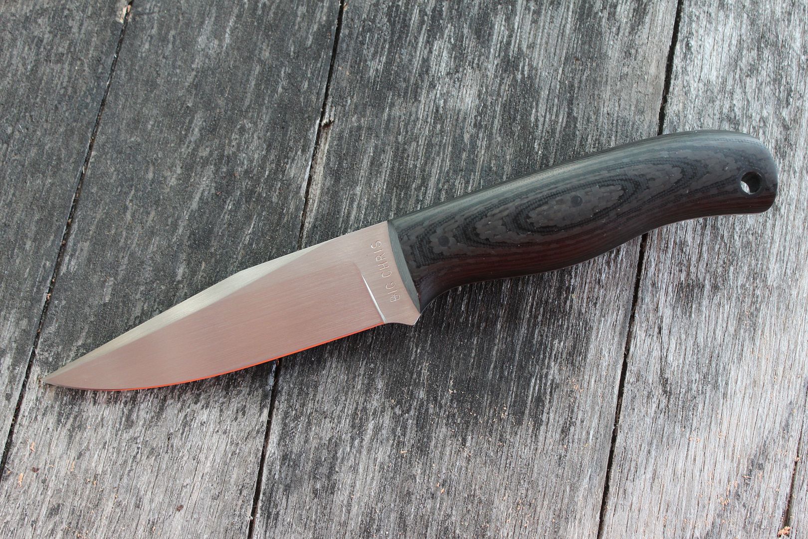

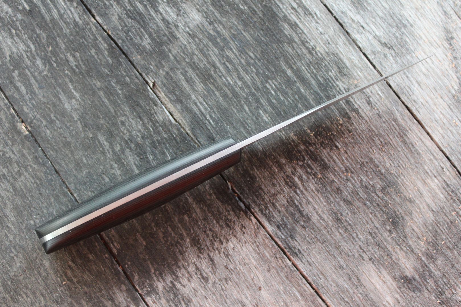

I have finished completely my first knife for the show.
It is my Pocket Fighter in CPM 154. I went outside my normal finishing techniques for several knives this year and did some hand sanded finishes. This one I only took to 280 as I really want for it to be used and loved. Let me know what you think.

That pocket fighter might be one of my favorite of your blade profiles so far! Love the long swedge. Handle looks great as always - what is the material?
Thanks dogrunner.
It is a composite of G10 and Carbon Fiber.
I got it at Blade last year and hope to snag more this year.
