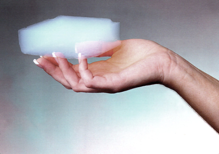

From the chemical engineering's point of view there are still the limitation of matter property on this planet. No matter how advanced of modern technology will go, scientist still can't find anything harder than diamond or any solid material that softer than soapstone.
While talc is the softest mineral, man has developed a softer porous solid in aerogels.
