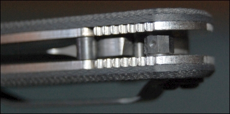

My TSF Gorgon has a cammed stop pin. I believe Jim is putting them on all his models now.
OK. So the pin is a hexagonal prism, or there is a hex screw that allows one to rotate the stop pin? Or both? Help!
Yes, you can rotate the hexagonal stop pin to give the liner locks more life. The 320 Precinct is like this as is the 765 Mini Monolock. Probably some others but I'm not sure.
OK. So you can rotate it to any of 6 positions to get a fresh spot for the blade to hit.
Would not, then, an octagonal stop pin provide even more spots?
Or am I missing the core concept?
So the hexagonal stop pin looks like this....a heaxagonal prism, correct?
Is has six sides and can be rotated, the pivot pin on the benchmade vicar I got from cray has one. I think the more sides, the smaller each side has to be in order to remain the same size, the smaller the side the less contact with the tang I would think.
I haven't been able to evaluate how effective if at all the stop pin actually is yet, if I keep the vicar I'll let you know if the stop pin performs as advertised.

like on the Benchmade 761??

So. What is better for a stop pin: less sides/less fresh spots but more area for the blade to contact, or more sides/more fresh spots but less area for the blade to contact?
Maybe that is the "core concept" I don't know.
Don't forget the effect of long term wear on the hole the stop pin sits in, over time they will elongate from the constant hammering as the energy from the tang to pin and the pin to frame. Everything wears eventually, the only way to prevent wear is to never use it and there are plenty of safe queens out there that'll never wear out their stop pins. ;)
Super helpful! Thank you!
Looking at the photo, I don't think the concept of the hexagonal stop has anything to do with a "fresh spot", but rather minute changes to where the blade is stopped as means of altering where the lock-bar sits against the tang (how far it travels, late vs early lock-up). By rotating the pin from a flat plain to a vertex one can adjust the lock position from early to late to find a "sweet spot" that the manufacturer couldn't figure out how to give it at the time of construction. This will also help compensate for wear at the tang/lock interface which is a FAR more notable problem than "stop-pin wear". Seriously, worn stop-pins??
In Benchmade 913 you can rotate stop pin and this way adjust your liner lock. I think that Emerson should use that idea.
I'm unsure about that...
I'd imagine a hexagonal pin would fit into a hexagonal hole, thus limiting contact to a flat plane. I could be wrong, maybe the ends are cylindrical.
Like T said, you'll still have forces acting upon the "other" end. No matter what, the wear is not limited to the blade tang and pin.
