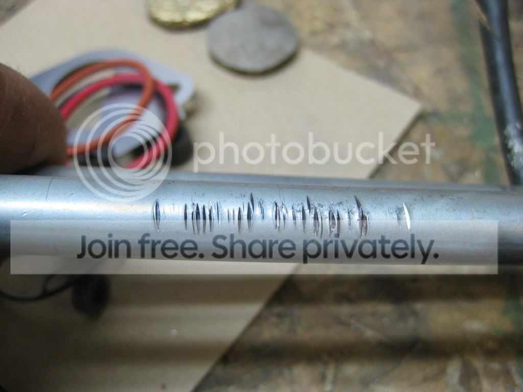

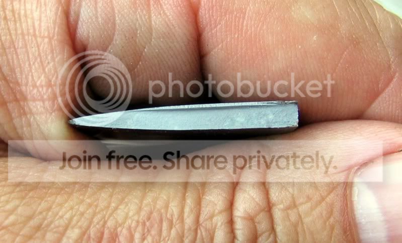

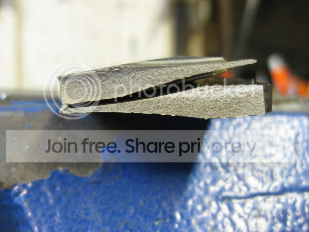

so for the test, I started whacking a piece of 5/8 home depot steel rod, not sure what kind of rod they have? and I only managed to put 1 small chip in the blade ( whacked the entire length of the blade three times ) and then broke the blade in the vice to have a look at the grain structure.

I put the tip of the blade in the vice just far enough so the vice had a full bite on the spine and it snapped at about 30 degrees, after the toaster oven heat treat the entire knife was a light straw color, I never drew the spine temper down to blue

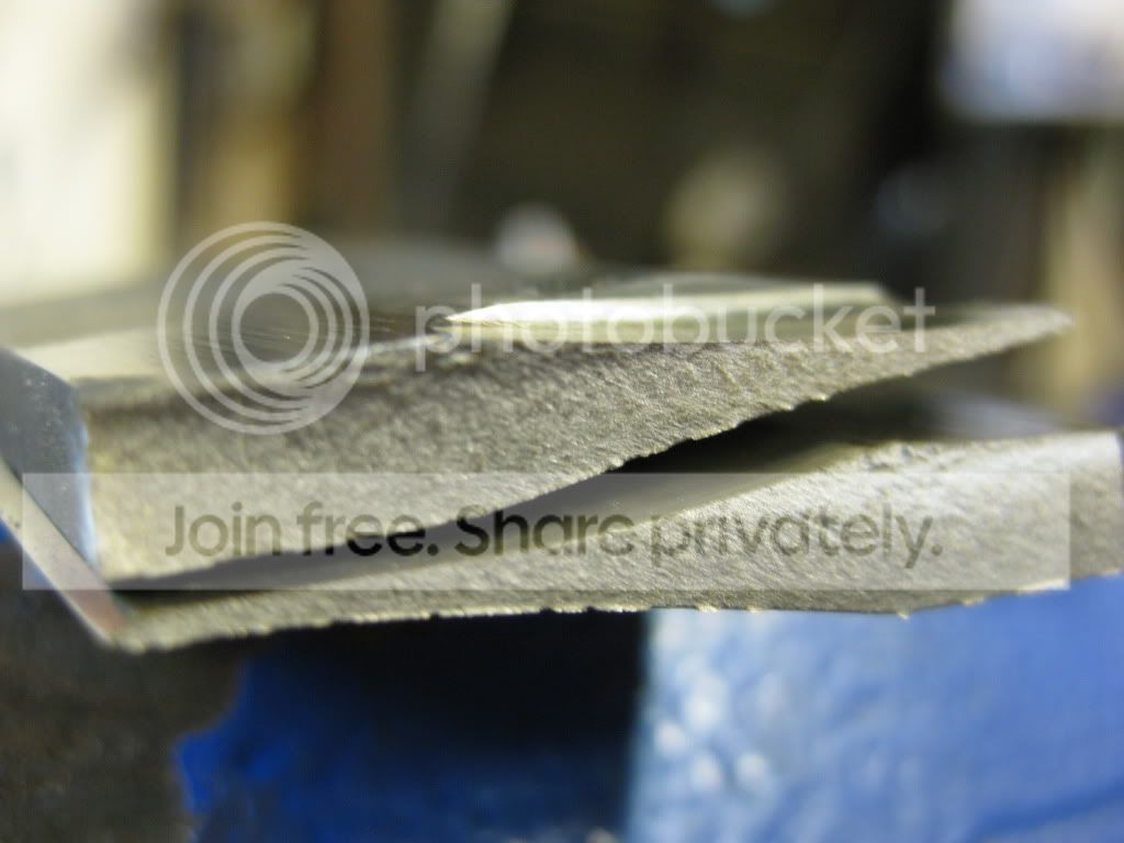

the grain looks OK to me. its not super fine, but it doesn't look like it sustained much unhealthy grain growth. looks like you did alright, but as I am going to start heat treating my own soon I will look forward to what others have to say.
I have to disagree with Nebulae, that grain size is WAY too big. It has hardened, certainly, but not to the level you need for full performance.
The grain size you are looking for looks creamy, almost glassy, with no real visible particles.
As a good example, and something to calibrate your eye to, snap a piece off of an old file (the tip, not the handle).
As soon as you see that you'll know what you're after. Good luck!
I agree with Andy... the grain is coarse. Here is a really good picture that illustrates the fine/coarse ends of the spectrum. Your seems to be in the middle.
A few points raised a brow for me...
1. There is no need to anneal prior to forging. You can omit that part from your process.
2. When you normalize, you should start at a higher heat(1600F or so) and reduce the temperature for subsequent cycles (1500F and 1425-1450F). You could even quench in there somewhere to further refine.
3. You said you soaked it for 5 minutes... in a forge or kiln? You have little chance of soaking in an open forge without overheating.
I think you may have not normalized as well as your could and definately overheated on the quench.

I'm not sure how much cardboard and rope constitutes a good test but here is what I cut, also I was cutting into my bench like you would with a kitchen knife and a cutting board, after all that I was just barely able to cut a few hairs off my arm

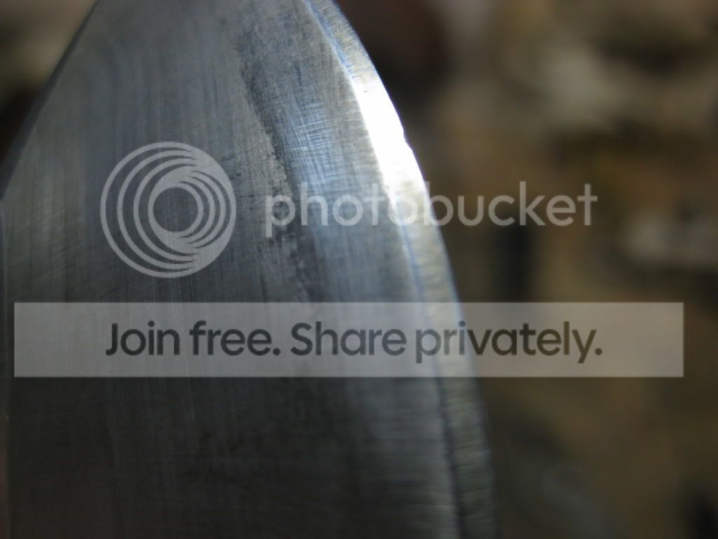

well I think I nailed it, I did what you suggested Rick raised my normalizing temp and then cut it back for 2 more cycles and I quenched a little closer to red color
the grain structure between the two is like night and day looking through my mag visor
That grain looks substantially better
