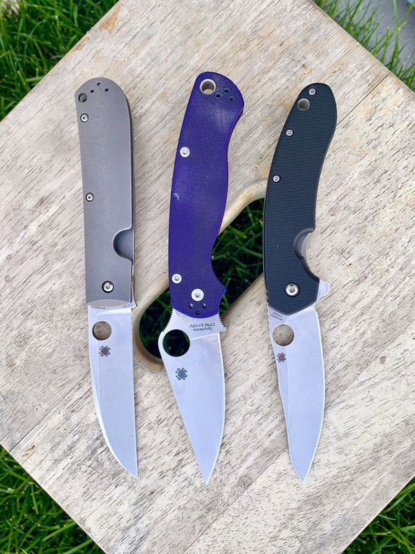

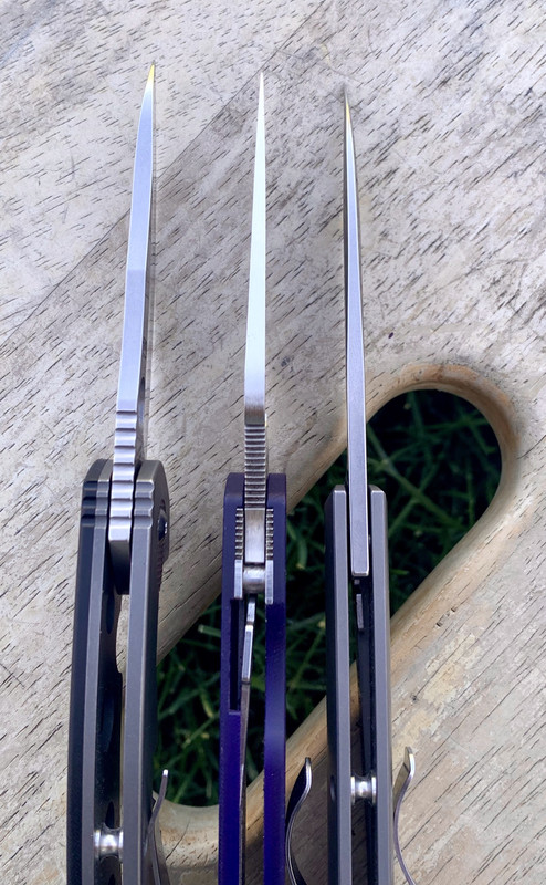

Blade grind and blade height has a lot to do with it.
I was reminded of this by the Spyderco Swayback.
The Swayback is 0.14” but there is some kind of magic in the hollow grind; it slices phenomenally well for it’s height and thickness.
The Southard with a thickness of 0.16” and a not-too-tall blade should slice like a boiled potato. It too has a hollow grind, less aggressive than the Swayback, and manages to do ok (though I wouldn’t place it in a “slicey” category).
The PM2 which is 0.14” and flat ground still manages to slice well for its thickness because the blade is tall and it’s ground thinner towards the tip.
That said, Spyderco’s UKPK at 0.09” with a relatively tall flat grind is a slicy little beast! The Chaparral crowd at 0.08” must definitely know slicey!
So what does it all mean to me? When I see a knife is 0.12” I expect it to be a relatively good slicer. 0.10” or less I expect it to be excellent. Thicker knives can still slice really well depending on blade geometry.
ETA Thread needs pics!
My UKPK is on a road trip with my son ATM.
