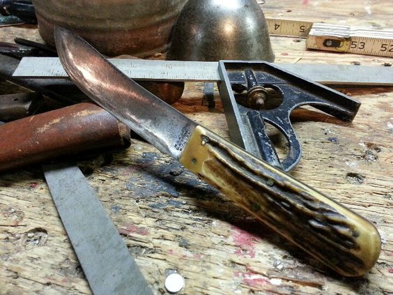

I have a 1906 MSA (Marbles) 5.5" (blade) skinner that is the pride of my collection. It was used daily by both my great-uncle and great-great uncle. It has field dressed and skinned literally 1000's of critters, been abused to some degree, and is 3/32" at best. It even survived me being a dumb kid who didnt know how valuable it is and using it as a throwing knife... Simple old school carbon steel. Takes and holds an incredible edge.

I like overbuilt stuff as much as the next guy, but there is a point where it starts to impact performance.
