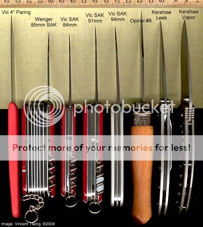

Typical thinner bladed knives -

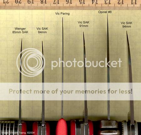

Blade thinness -
Details:
Not surprisingly the thinnest blade of this bunch was the ($4) Victorinox/Forschner 4" Paring knife - that's probably one of the reasons (other than cheapness) that this knife is so popular - because it is very sharp and cuts through things well - as a good paring knife should do. For a cheapo knife it actually has a good distal taper. Again not surpringly it has quite a lot of flex in the blade.
The next most flexible by feel was the Wenger SAK (85mm closed - their standard size) if one squints carefully at the photo one can just make out it is thinner than the smaller 84mm Victorinox SAK (look carefully at the tangs near the handle).
The Opinel #8 is somewhat flexible in the ballpark of the 84mm and 91mm Victorinox SAKs - perhaps the SAKs are a bit stiffer - but not enough for me to make any big deal over it - this is the degree of flex I find "tolerable"/acceptable for an EDC general purpose blade -
although before this I never really complained about the Vic Paring knife's flexibility - so maybe there is some "bias" here.
The 94mm Victorinx SAK - as in the Soldier and the "Pioneer" Alox series blades are noticably thicker and also noticably stiffer - where I would put the Opinel #8 and the 84mm and 91mm Vic SAKs at the borderline between flexible and stiff - the 94mm Alox SAKs would be classified by me as stiff bladed - as are the Kershaw Leek which is noticably thinner than the Vapor.
