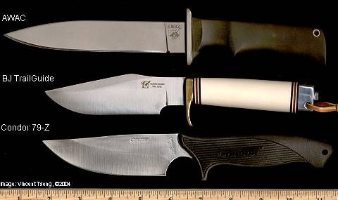

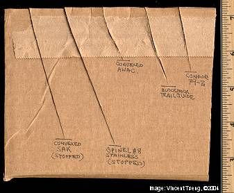

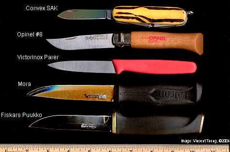

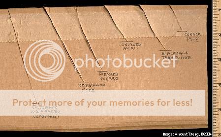

I posted this in another thread ( Convexed Edge )
These ad-hoc/informal/UNscientific cardboard cuttings demonstrate how well thinner blades out cut even very good geometried thicker blades -
Some ad-hoc/informal cardboard cutting.
In spite the fact I tried to make it as "equal" as possible - it is not that consistent (*see later) -
but still a reasonable indicator (of sorts )
Cutting into regular corrugated cardboard across the corrugation -
Where it says "stopped" in the Victorinox 3.25" Parer, Opinel #8 stainless and the convexed Victorinox SAK - they would have cut all the way through - so I just stopped when I thought it was enough - so those are not meant to be compared in absolute terms merely to show that they did easily out cut the thicker knives despite some very good profiles/geometry.
[note: the Victorinox Parer is as-is - ie: flat ground with regular plain bevel edge - it cuts so well mainly because it is a very thin blade]
* inconsistency - Notice that I re-did the BlackJack stuff and in one the Condor 79-Z cut less than the Convexed AWAC and in the other it's reversed - but they are still in roughly the same ballpark.........
These were the knives -
