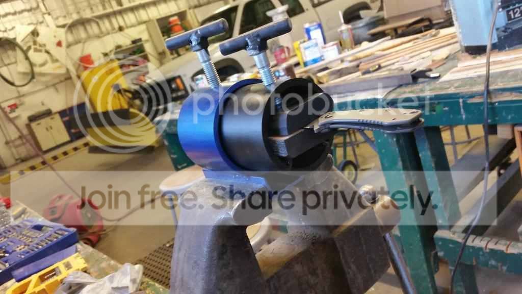

Any cheap ideas out there for clamping a blade (horizontally)? in my bench vise? I like hand sanding that last bit of the handles since I only have my 1x30. Not much room to run the blades vertically on the belt. I'd like a way to clamp the blade with the scales facing up, and protruding the vise, so I can see what I'm doing. Am I just going to need a fully adjustable vise? Or has someone made a cool little gadget to help with this?

I built a super cheap knife vise. I used 3" square tubing about 6 inches long. I then fit a pipe inside. Drill and tap a hole for a thumbscrew. Then I glued leather on two pieces of flat steel bar and hit them with the grinder until they slid into the pipe. Now you have a knife vise.

Here is the vise I recently built, mostly all from scraps we had laying around at work.

Here is the one it made. Works great.
