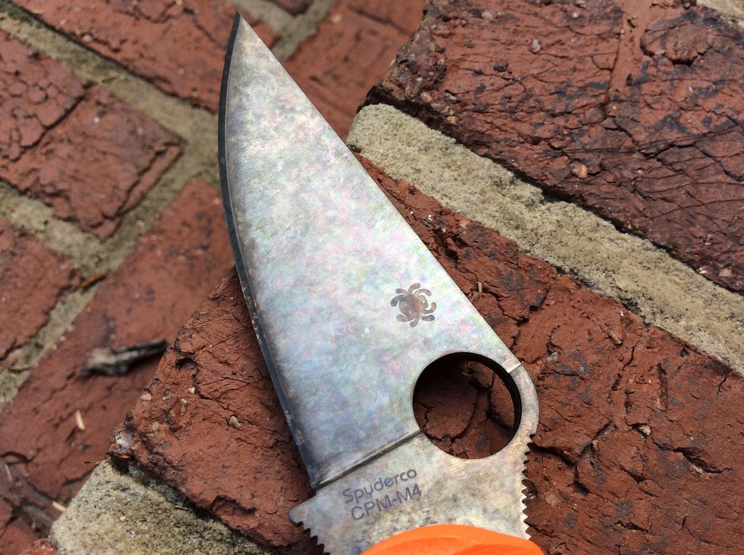

More patina on the M4....
It was just fruit/veggies/starches/meat and I left everything on the blade to "season" it. I'd rinse it after while and did a 30 minute vinegar soak to lock in the colors!
I've had really great luck taking strips of paper (post its in my case), soaking them in white vinegar, and sticking them to both sides of the blade at once. They don't do much at first, but as they begin to dry the blade begins to patina. I think these high carbon carbide steels produce colors of blue, bronze, etc naturally vs normal plain carbon steels which just turn darker typically.

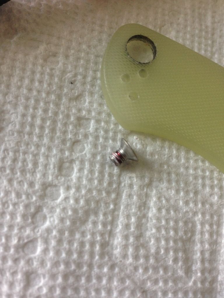

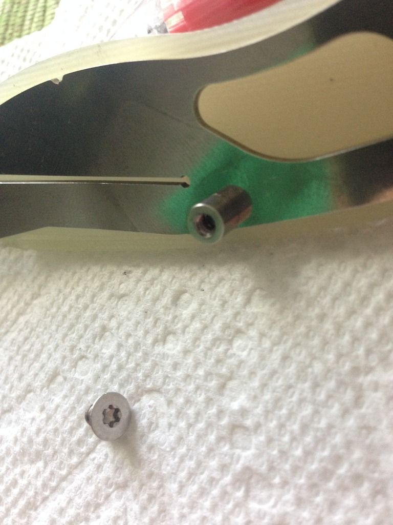

did anyone else have a bunch of red lock tight on the pivot/scale screws when they took theirs apart?
My pivot screws were lock tighted on pretty good. I hit it with a lighter for a few seconds and it broke loose. I can see how easy it would be strip these screws out if you just try and "muscle" them out!

i was surprised to see the red. I did try to muscle it out and stripped a scale screw. i needed a pair of channel locks to get the last screw out of the spacer. I used a hair dryer and then lighter as well. got it done but it was a pain.

Yeah, I've learned that if I have to apply more force than normal, I'll heat up the screws and that will usually do the trick. I've never stripped any screws, only because I learned from others on here that have!
I'm ordering some scales in the next couple of weeks and switching these to my DLC s30v blade. Thanks for the heads up. I think I'll try the tip of soldering iron.
