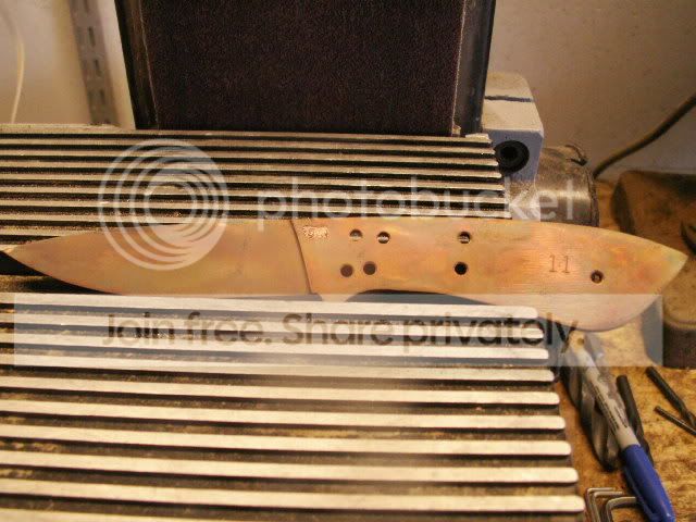

Some of you know I started a thread inquiring into a tumbled finish. Did some tests, found a media, and now I have blades back from HT. Let's recap one more time. I have about 4lb of 1/8 and 1/4 dia non abrasive ceramic cylinders in my reloading tumbler. Here is the thread for those that want to catch up.
http://www.bladeforums.com/forums/showthread.php?t=449951&highlight=tumbled+finish
Here is the blade after Mr Bos graced it with his skill. This one is a beater since I ground the plunge too deep on the spine, and I need to learn how to use a handstamp for my mark. Think back in the day when you got credit card receipts and the imprinter made dupes of the card info. I will check on it in the morning.
The hardened steel does take longer to get the same effects from testing, but that was to be expected. 8 hours did not do much.
huh, neither did 24 hours. :confused: I think I might something to add a litle more aggressive. Time to experiment again.

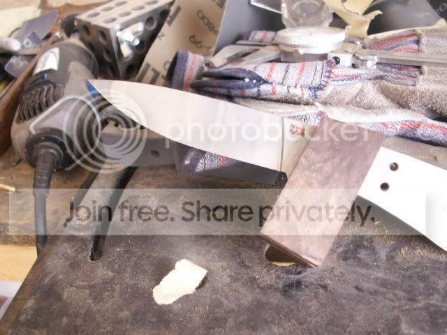

Well, after 36 hours the blade is ...well... polished. To a mirror practically. I might try the ceramic with play sand or something. I need more abrasiveness (is that even a word?) I might buy some steel shot or maybe a light cutting ceramic. I am gonna go ahead and finish the knife to finish the thread. It does look pretty nice, just not quite what I was looking for. Guess I could take a pic.
Here it is. I am mounting the walnut burl guards. there is a slight haze on the blade, but I bet a rub with simichrome would get rid of that.
