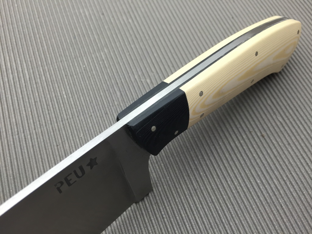

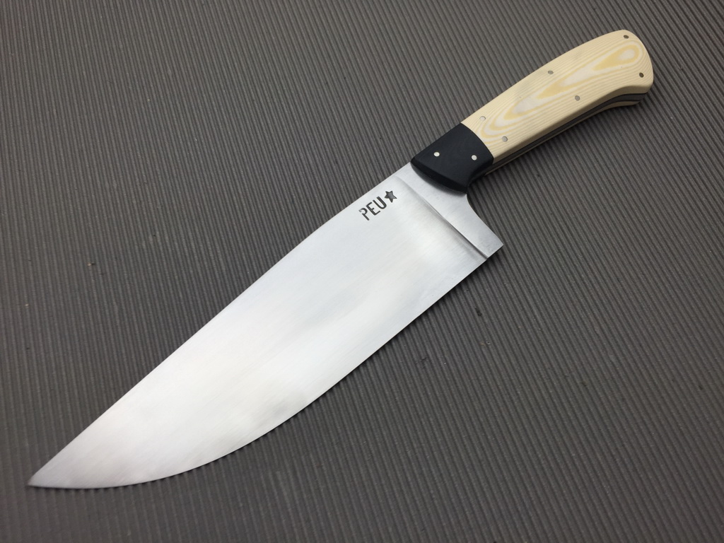

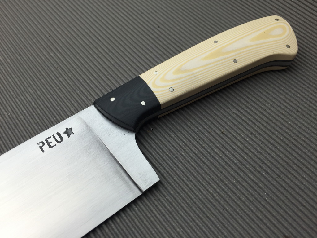

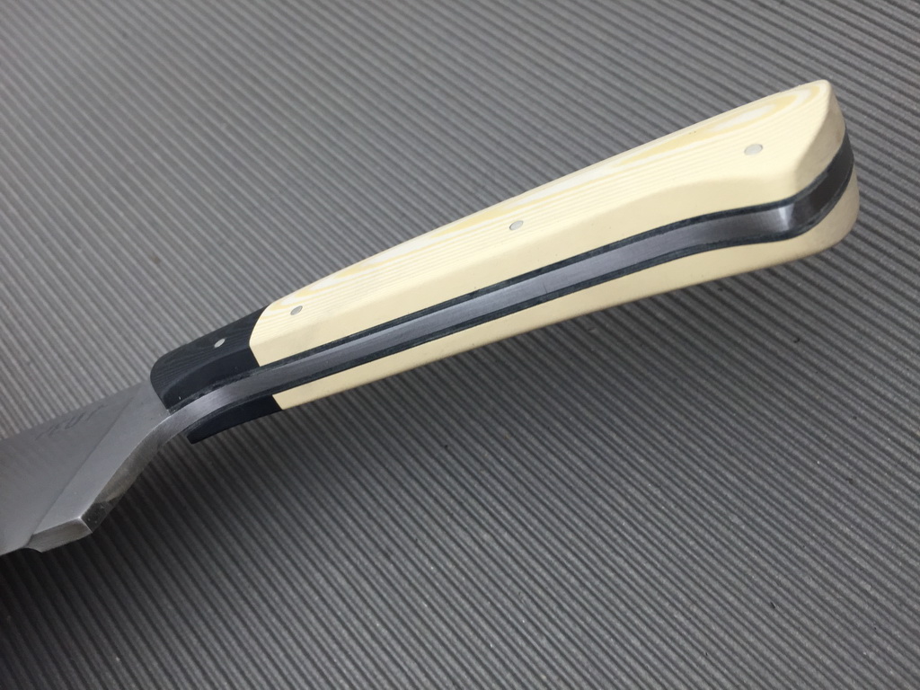

Thanks Frank, since you like them, here are some photos of a kitchen knife made of this steel, finished it minutes ago.
180mm blade, 300mm OAL, 3.3mm thickness, 50mm width. Handle black and ivory paper micarta.
